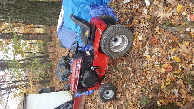

Dball 12 #1 Posted November 12, 2016 K guys i had purchased a 520hc from a guy knowing thay he or who ever had taken the swept axle off the front of the tractor and replaced it with a non swept axle y would some one do that ah any way i tryed to mount my 48 in mower deck to it as i wanted to see how shee mowed when.i.went to.put the belt around the pto wasnt long enough so im unsure on what is going on i cant see the changing of the axle change the length of my mule drive belt would it🤔or could the guy had put a mule on from a.different.machine.are all the mule drive belts the same or differ in length.this may be a dumb ? But i am a new wheel horse addict i am stanting to thing i need help with my habbit lol here is a pic of the tractor 1 Share this post Link to post Share on other sites

Dball 12 #5 Posted November 12, 2016 It is an 89 520 hc when i get home i will tak a pic of the steering up front as to me it looks tamperd with becouse their are 3 holes in the plate the tie rods hook into but guy said that the swept axle was taken off but even at that y would the belt change as said i am new know a little but not everything i thought the swept axle started in 89 ? Share this post Link to post Share on other sites
cleat 6,715 #6 Posted November 12, 2016 HC would have came with a swept axle. Need more pictures to figure your belt issue. Cleat Share this post Link to post Share on other sites
