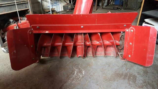

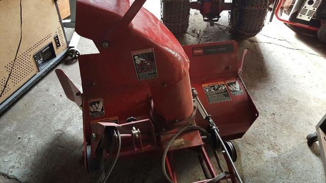

Firecop119 5 #1 Posted November 8, 2016 (edited) Hello all. I'm sure there is a post already about this but I can't find it so thought I would start a new post. I have a 1993 520h and I'm looking at a 2003 79362 snowblower to buy but not sure if it will work on mine. The tractor it's on now is a 2003 and looks like a 520 but don't know model. Only going by pics. The weird thing I noticed on the blower is that it has pulleys and belts on each side of the blower. Not sure how that works and hooks up. Any help will be much appreciated Edited November 8, 2016 by Firecop119 1 Share this post Link to post Share on other sites
roadapples 6,983 #2 Posted November 8, 2016 (edited) Pulleys on left side in first picture are the front mule drive. It will work...I think. May be for the XI models.. Edited November 8, 2016 by roadapples Share this post Link to post Share on other sites
wallfish 17,485 #3 Posted November 8, 2016 The pulleys and belt on the left side are not part of the blower. It's a mule drive for a mower deck. That blower will fit your tractor 1 Share this post Link to post Share on other sites
Firecop119 5 #4 Posted November 8, 2016 I see the lift bar coming from the center of the blower. How does that hook up to my hydro. It looks like a open end pipe. Flag? Share this post Link to post Share on other sites
608KEB 796 #5 Posted November 8, 2016 The wings on the snowthrower need to be flipped. They need to point straight ahead. 1 Share this post Link to post Share on other sites
1995 520H+96+97 937 #6 Posted November 8, 2016 23 minutes ago, Firecop119 said: I see the lift bar coming from the center of the blower. How does that hook up to my hydro. It looks like a open end pipe. Flag? Yes, Flag. I don't see it in the pictures. Share this post Link to post Share on other sites
pfrederi 18,322 #7 Posted November 8, 2016 Check Wheelhorseman in the vendor section for a flag. Share this post Link to post Share on other sites

gwest_ca-(File Mod) 11,241 #9 Posted November 8, 2016 Listed as fitting the 300-Series tractors but that is all they were building during these model years. 300, 400 and 500-Series all use the same chassis. Garry 1 Share this post Link to post Share on other sites
