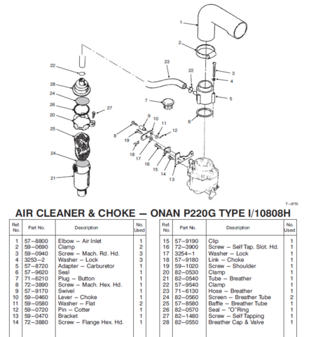

Take the crankcase breather apart, the steel wool maybe touching the four balls.

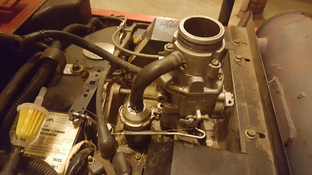

26 minutes ago, Zappullae said:
I was looking at this Flip pump...
http://www.ebay.com/itm/Flip-MFG-Generator-Fuel-Pump-Fits-Cummins-and-Onan-149-1982-149-1544-149-2187-/181663177513
And wondering what that can was off the carb.  Now I know.   I'll take a look in the morning.
Thanks for the help all.

The breather looks good.  I pushed the steel wool down a bit but don't think it was interfering with the steel balls.  The balls move freely too.   I cranked with the breather open and didn't get much vacuum at the gas inlet of the pump. So I took the fuel pump off and there's good vacuum / pulse at coming from the engine.  There was also some gas in the pump but still nothing comes out.  Time to try a new pump.
