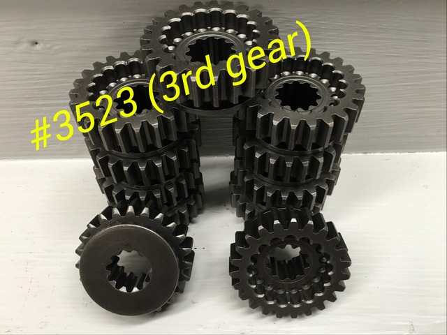

Look at what the (tooth fairy) dropped off
stevasaurus
OMG Lowell!!!   Are you kidding me...are those # 3523's  ???:bow-blue:
Make sure you read post #16 in this thread to see if this gear will fit in your transmission.  :handgestures-thumbupright:

Yes they finally are done!

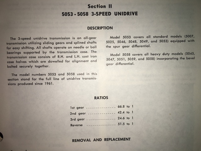

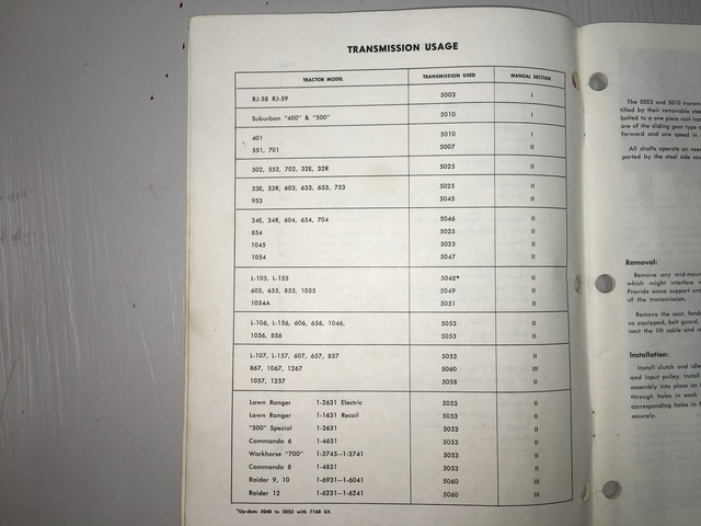

What trans will those work In? I am not savey enough to know.
Glenn
wheelhorseman
 Here is a couple pictures out of my transmission manual, the gear should work on most of the two-piece 3 speed transmissions except the bevel gear transmission which was used in the 953, 1054 and such - see pictures

OK...that gear will fit into most RJ transmissions, and Suburban Transmissions.  Note:  These are the 3 piece transmissions #5003 and #5010.  Wheel Horse used the #3523 forked gear in both of these, but there was a point where they changed the number of splines on the spline shaft and they changed the number of splines in the 2 forked gears accordingly...but not the part number.  You have to count the splines to know if this gear will work in your transmission.  Lowell's gear is the 11 spline...the older model has 10.
   Lowell's gear will work in all the 2 piece, 3 speed uni-drives...except the trannys with bevel gear differentials.  Lowell's gear will also work in all of the 4 speed, uni-drives.
   If you are not sure, check the parts list for the transmission that is on your horse...and count the splines.  :handgestures-thumbupright:  The service note is on page 12 in the transmission manual.

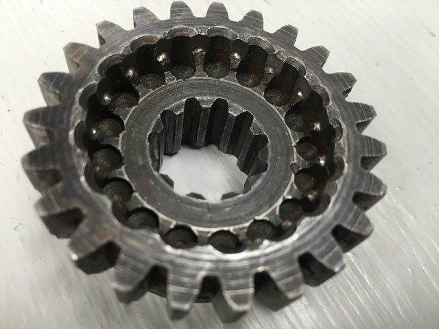

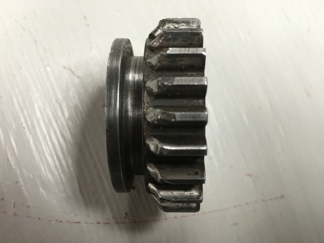

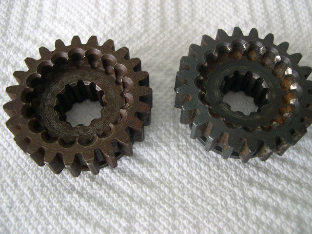

If someone has a pic of a boogered up one here would be a good place to show it off... please post.
Racinbob
Here's a boogered up 3523 and a NOS. Jim, you knew I would, didn't you? :D3523 Comparison.JPG

stevasaurus
I knew you would Bob.  :handgestures-thumbupright:
WHX??
Oh Oh  ....that one on the left of Bob's looks just like the one I just buttoned up in a 5060 :angry-banghead:
Racinbob
Then you're in good shape Jim. The one on the left is the NOS gear. The one on the right might be OK for a non-worker as long as the input gear was decent. :)
Edited by Racinbob
stevasaurus
If it was in a 5060 it wouldn't matter...different number gear.  :)
Racinbob
I think he was referring to the inner teeth Steve and not thinking about the number of spline teeth.:)

Bob the one on the right looks new compaired to this one:text-lol:
