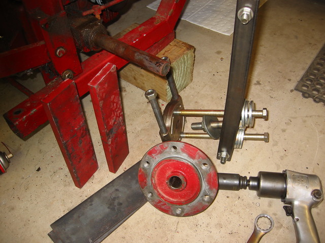

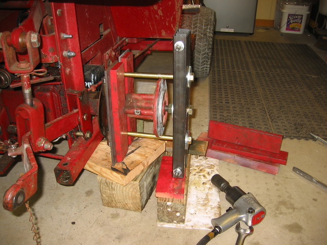

Looks good Lyn.  That should do the job.

Yesiree, thats the way to go to get those stubborn &%# hubs off! With those aggravating things it takes a serious heavy duty puller of the type you have there.

It would be interesting to see a pic(s) of that tool in action.
A four lug version (example: GT14 hub) would also prove interesting to see in operation.
A video would be fascinating, but based on my experience pulling decades long installed hubs, I'm not sure we have enough bandwidth available here at RS to pull that off.
Generally speaking, hub pulling isn't a 10 minute job.

If this tool proves out, I might consider making them to sell.  If I had the bolt sizes and patterns plus hub center sizes (hole size in wheel) for other popular Wheel Horses, I could incorporate those into the same tool.  Hint: they would be expensive, but there is economy in quantity as I would run them on a CNC.  Should I make more, the handle will be recessed into the disk and the disk would be made of heat-treated alloy steel.

Just an added note to to tell of how I use this type puller - mine looks just like Lynns except for the handle. Instead of a handle I use my 3/4" air Impact wrench driven by 110-120psi of compressed air. The constant 'hammering' will slowly (usually!!) back the hub off simply holding it by hand.
I had a D-180 that I finally had to give up on getting the hubs off even using this method - ended up cutting them off!! (has anybody ever said how HARD!! these *%$#^ hubs can be to get off!!)
Obviously not everybody has this ability, but if you do, give it a try...

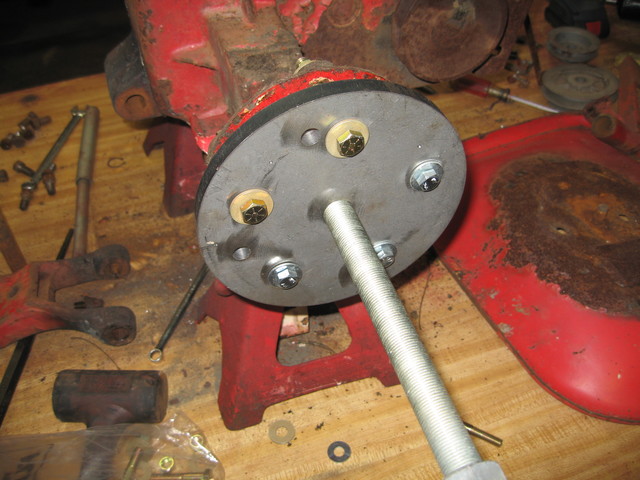

here's mine, bolt pattern for 3,4 and 5 holes
