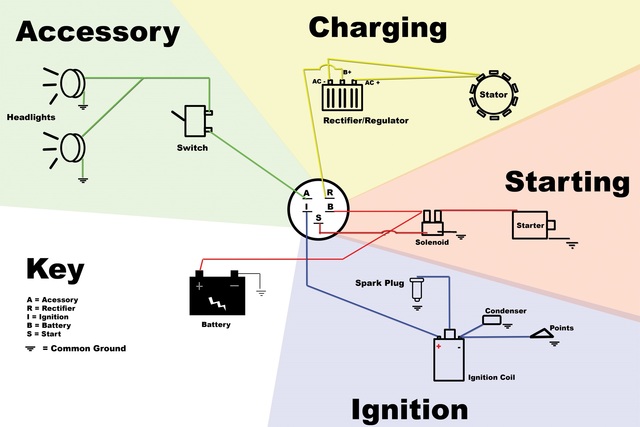

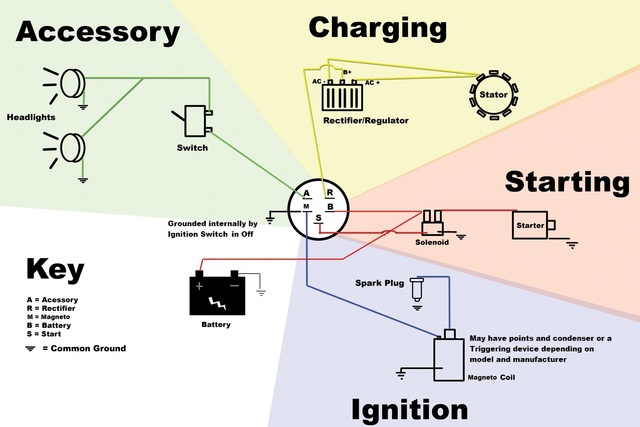

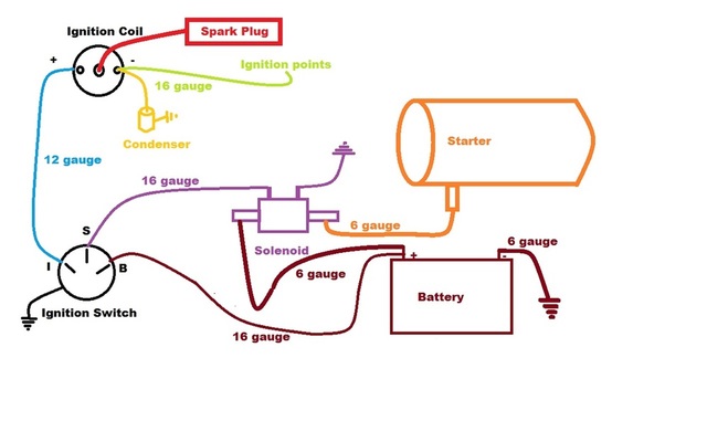

4 minutes ago, classicdmax said:
should there be any inline fuses??
Fuses are a good thing, lots of older :wh: didn't have them and should have. Presuming you have a battery ignition system with points and a coil the following simple diagram should be helpful. The wire sizes are not Gospel, if you want to use a larger size (smaller number wire gauge) that is fine. The second and third are for reference for other systems.
  • Like 7
