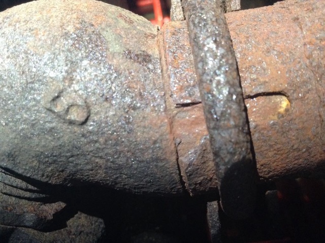

Detector 72 #1 Posted October 25, 2016 I need some ideas on removing my muffler, it looks pretty bad. I got the clamp loose but the muffler where it slides on is brittle and flakes away easy, I used a small chisel and a jeweler hammer and with one light tap it chipped as you can see in the photo. I talked with the guys at POR-15 today and decided to go with their brush on high temp coating, the rep recommended sand blasting and hand sanding as a last option for best results, I may have to go with the last option unless you guys have some tips. Share this post Link to post Share on other sites
DennisThornton 4,769 #2 Posted October 25, 2016 Bigger hammer? Oxy/Acet torch? Just get after it with your hammer and chisel and spread the split area. You mean to remove it, repaint and reinstall? I've missed something? 1 Share this post Link to post Share on other sites
Detector 72 #3 Posted October 25, 2016 That's the issue, I lightly hit it under the split area and its chipping instead of spreading open. Sorry but yes I meant remove, sandblast, paint, reinstall.... Share this post Link to post Share on other sites
Hossenfeffa 49 #4 Posted October 26, 2016 Heat. Preferably with oxy acetylene torch set up 2 Share this post Link to post Share on other sites
Detector 72 #5 Posted October 26, 2016 1 minute ago, Hossenfeffa said: Heat. Preferably with oxy acetylene torch set up I have zero experience with torches but a guy I know does, I'll let him take a look at it. Thanks 1 Share this post Link to post Share on other sites

DennisThornton 4,769 #8 Posted October 26, 2016 Sandblaster or electrolysis it will look rust pitted even after painted... If sandblasting blows through you had very little time left anyway. 1 Share this post Link to post Share on other sites
Detector 72 #9 Posted October 27, 2016 4 hours ago, DennisThornton said: Sandblaster or electrolysis it will look rust pitted even after painted... If sandblasting blows through you had very little time left anyway. Yep, you right, one backfire & I'd be in trouble. I'm might as well be in the market for a new/used muffler either way. I looked under my model number 31-12KE01 and could not locate it for the M12 on Partstree but I may had overlooked it, I think it is a Toro 94-3739 same as the 312-8 with a hefty price of over $200. Share this post Link to post Share on other sites
