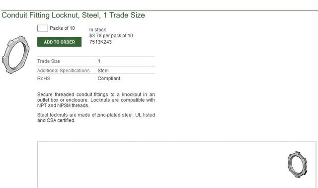

If it just loosens up but isn't falling out try a lock nut like this (used on electrical conduit).
