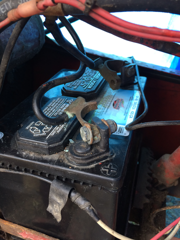

I initially started it yesterday after it sat all summer.  It wouldn't turn over at first, so I charged the battery for 4 hours and afterwards it started without a problem.  It ran for about 10 minutes until running out of gas (whoops).  I filled the tank, started it again, and worked it out in the pasture with the tiller attachment for about 45 minutes.  Then it died.  The engine just shut off.  I turned the key and got nothing, not even a click or an attempt to turn over.  I assumed this was a dead battery, so I went to home depot and bought a new one.  I installed it just like the old one (see photo).  I cleaned the terminal cables with steel wool.  Still nothing. Totally dead.

Looks like you should change your battery cable ends. They look kind of corroded to me.
  • Like 6
THOSE CABLES ARE SHOT!!!
See if you have 12 volts at the ignition coil "+" presuming it is a battery ignition system. Take a set of jumper cables and go directly from the battery to the starter and "-" to ground eliminating the present cables and switch; if it cranks over you can drive it to the barn.

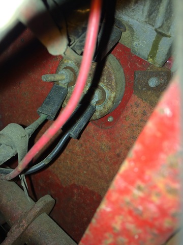

So here's a picture of the back of the ammeter.  I found that the black wire is disconnected.  But I'm not sure where it's supposed to go.  Anyone know?

Both wires looked hooked up to me.  Put a jumper across the two terminals
Bowdoinham Dan
The black wire is disconnected at the other end.
pfrederi
one wire should go to the big terminal on the solenoid (battery side) the other to the B terminal on the ignition switch

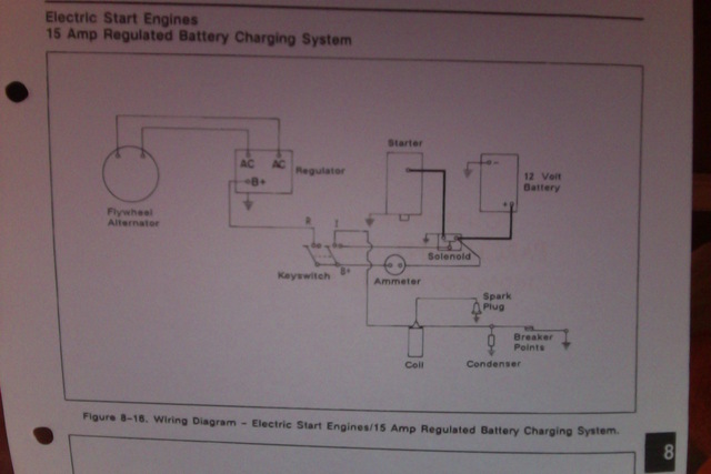

It's a K241S engine...I think the S signifies an electric start engine.  There are wiring diagram photos in the service manual, but I don't know if I have a 25 Amp or a 30Amp battery charging system.  Diagrams are different.  How can I tell?

The tractor's ID plate may be under the dash housing on the flat vertical panel. Should have the model number and serial number on it. With those numbers we can make sure you have the correct manuals. I'm thinking you charging system will be 10 amp or 15 amp.
Bowdoinham Dan
Confirmed--It's a 15Amp charging system (diagram attached).  Now I just need to go find out where the black wire is supposed to go: solenoid or switch.  There's isn't a terminal hanging off it.  It looks like it pulled away from a junction that was used to repair it at one point.

All the electricity to run your tractor goes from the battery to the big terminal on the solenoid.  From there it goes into the small wire also hooked to that terminal then through eh ammeter to the battery terminal of the ignition switch.  then depending on the position of the switch it goes on to the ignition system (coil).  Trace that path and see where you are disconnected.  any break in that path and tractor will not run

Fixed!!!!
An ammeter wire was disconnected from the solenoid, so I bought a $.44 wire terminal and reconnected.  Running fine now.  Thank you everyone, I learned a lot about my tractor :-)
