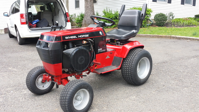

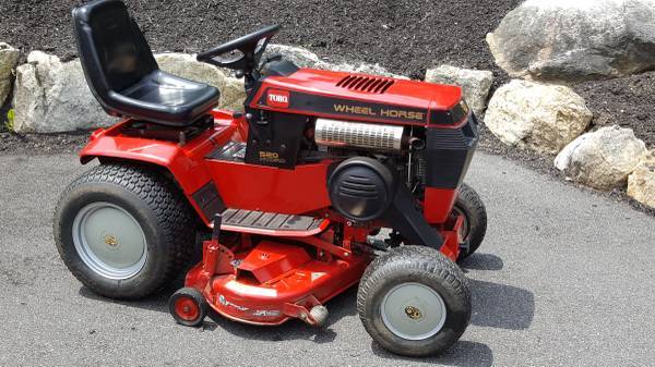

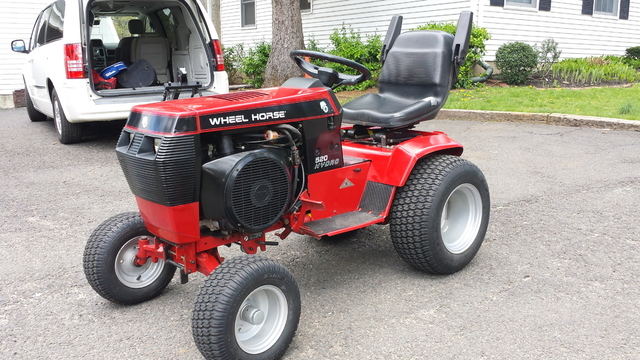

A little teaser shot, original owner, 342 hours on the clock, 42 inch deck.
Glenn
  • Like 8
Forest Road
Saw it on CL. Did you get it?
JERSEYHAWG /  Glenn
That's the one, I just have to get it. Maybe this weekend.

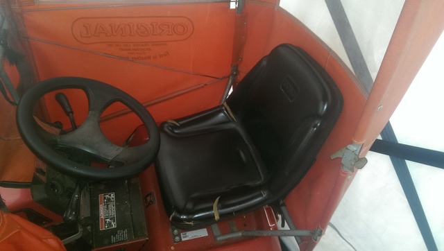

DougC
This is the new style cab. I have been told it is a much roomier cab interior wise than the older style cab.
JERSEYHAWG /  Glenn
Doug, that is the correct 520 cab. could you post a picture showing the back please, I was told it has a zipper up the back in the center. to make it easier to re fuel the machine. I would be interested in seeing that, also, if you wouldnt mind, that model number again, and where do we get that cab? I can only find the 5xi cab on the website. Thanks again for your help.
Glenn
DougC
Glenn, www.originalcabcompany.com part number 79978 fits classic 300, 400 and 500 series .
I got a tip from a friend on this forum that New Haven Power Equipment in Vermont had them on sale and they did so I bought from them and they UPS'ed it with insurance to my door an about 3 days.

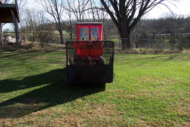

You are correct about the long rear zipper in the center of the rear panel for ease of fueling. That is a great feature.

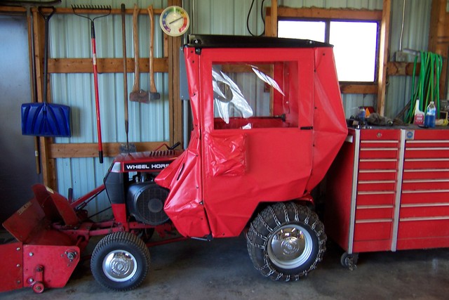

Wife loaned our camera to her church for a project so I can't show you a picture of the back for a while.  :lol:  I do have this one but sweeper blocks the view.

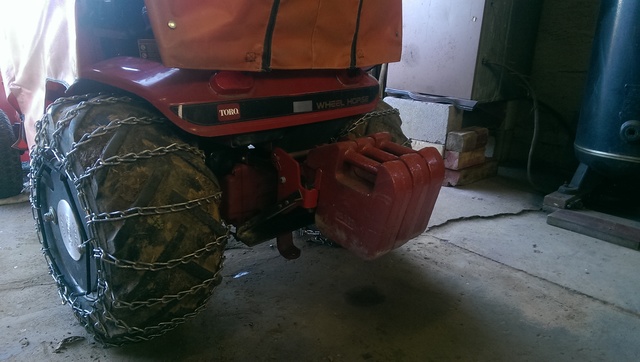

Even with that said, I am adding rear ballast weights to counter balance my two stage.  75# wheel weights and my fat a$$ weren't enough when I had to back up the hill with the blower raised.
Kurt

I have 75# cast iron wheel weights, 5 gallons of RV antifreeze in each tire, plus the 3 43# suitcase weights hanging off a fabbed rear hanger and I believe it would climb a tree now,Jeff.

I added a hitch and 100 lbs of barbell weights.  I'm hoping that is enough.  150lbs of wheel weights, 100+ lbs of barbells and my 250+ should be enough.  At least I hope so.  We'll see.  I hope you are right about climbing a tree Jeff.
