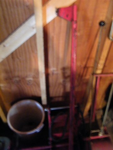

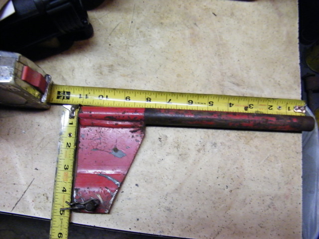

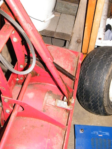

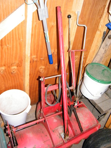

stevasaurus 23,012 #3 Posted October 10, 2016 Here is how it works. This should be very similar to what you are looking at. There is a tube from the bottom of the blower that has what is called a "flag" that goes in the end of the tube and hooks into the lift mechanism on your horse. The flag. Blurred picture, but I think you can see what is going on. You can see the lift tube hooked up in this picture. This blower also has a guide pulley that attaches to the frame. You blower may have this pulley as part of the blower itself. Depends on how new it is. Follow the belt to see this. 1 Share this post Link to post Share on other sites
pfrederi 18,264 #4 Posted October 10, 2016 The blower can hook to your implement lift that is run by the hydro system . You need to make sure that it comes with a lift rod and a "flag" The lift rod is like a pieces of pipe flattened on one end that is about 4 ft long the "Flag is a 1 ft lon 3/4" steel rod witha flange (flag welded on one end) Look in the manula section here for your unit. Share this post Link to post Share on other sites
