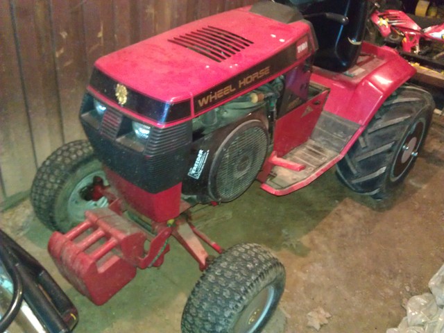

wallfish

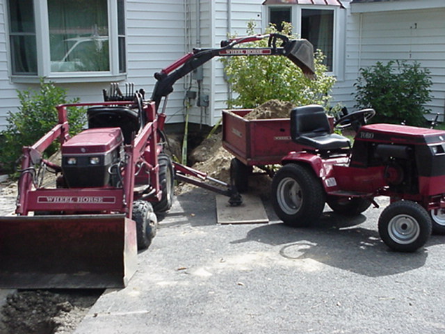

Original front rims for a C101 are 8" so you'll need weights to fit those. Other brands will fit too but some are are too deep in the center and will hit the spindle so keep that in mind.
This is the only pic I could find of mine. They are Bolens weights on the loader tractor.

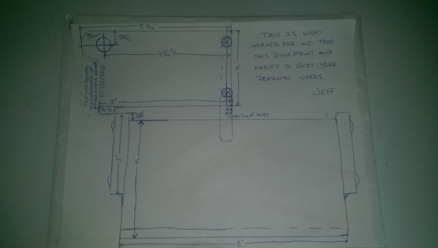

WVHillbilly520H

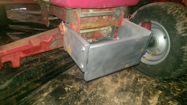

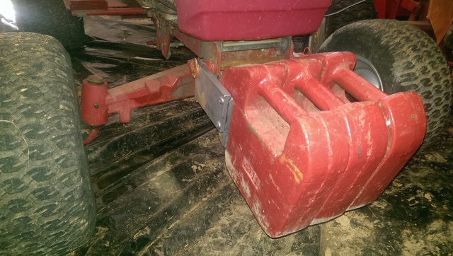

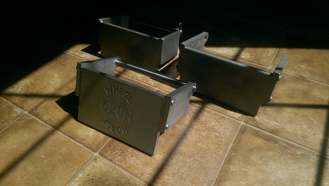

My front suitcase weight hanger bracket that I made for my 520 fits B,C,3/4/500 series and I have thread with plans/blueprint to make them,Jeff.
cschannuth
I have one of Jeff's hanger brackets and they are the best I've seen.
Devron30
Those are awesome! Great work! I need to find me some of those 😀

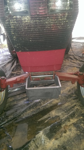

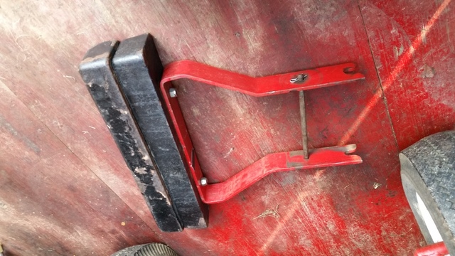

C-85
This is what I added for a front weight, it's independent of the plow
C-85
cschannuth
C-85
 If your wife is like mine she probably loves having things like that on her kitchen counters. LOL

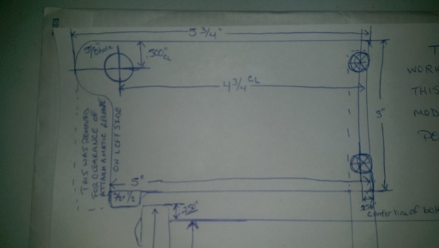

WVHillbilly520H
The weights are actually a "JD" product approximately 42-3 lbs each not certain may be sold at Home Depot also and here's the plans (for the 3/4/500 series might have to adjust as necessary to fit the c101 if it's a black hood as did for Craig) if you are willing to fab one up or have it made since I moved departments at work and no longer have access to make them,Jeff.

I need to find someone who makes some kind of front weight system for my c100 because I am no fabricater and wouldn't even know where to start.
WVHillbilly520H
Is there a metal fab or machine shop nearby you? If so copy/print my plans and take them there, not sure but may be selling 1 more of mine, and I want you to know that these are only for ballast when using rear/clevis hitch mounted implements, the snow plows won't raise with these type of weights hanging off the front but then there's the rare WH version,Jeff.

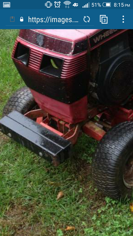

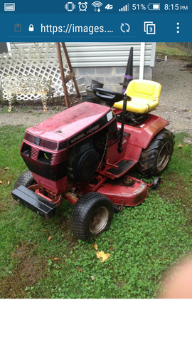

WVHillbilly520H
Here's a pic of the factory front weight/bracket in use with mule drive/mower attached (BTW not mine),Jeff.
