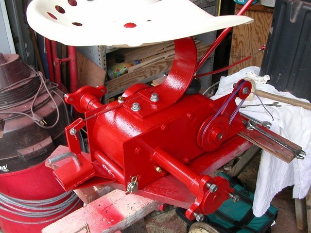

A hunting trip last week got in the way of progress on this project. But i'm back at it today, sorry for the delay.  I was able to get the trans put back together took a few photos. but not very many photos because i would have had to wash my hands every 2-5 minutes to run the camera phone.
After assembly it is much tighter and smoother than before.no more axle slop. I don't think the differential was even working corectly before, and the shift linkages were not working correctly either.
Turned out the little spring and pin was rusty and the detent balls were getting caught up a bit.
I also gave the inside a coat of glyptal after I bead blasted the whole thing.
I found a rubber bellow in Mcmaster that looks like it will work for the shifter boot. what's everyone else using?
http://www.mcmaster.com/#9744k12/=14qelan
Once the sealant sets up on the gasket I am going to replace all the bolts with new ones and will be sealing them up.
I only had one hiccup during assembly and luckily it was early on. I installed the new bushings in the diff and completely forgot they came long so i pressed them out to leave clearance for the pinion gear and just turned them down in place.
I didn't have a puller that would work with that small a bearing so i welded 1/4" bolts to the bearing races and just used a slide hammer.
here's a few pics
trans-Done
next step is the chassis.
