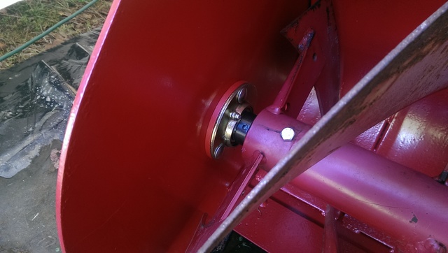

Yes I did the bearing upgrade but I couldn't find a 4 bolt bearing retainer so you have to redrill holes for the 3 bolt style and add a 1/4" spacer to shim it out,but it is the same retainer used on the single auger shaft or impeller shaft just next size up bearing, got mine online the "big bearing store" also #40 roller chain in bulk,Jeff.

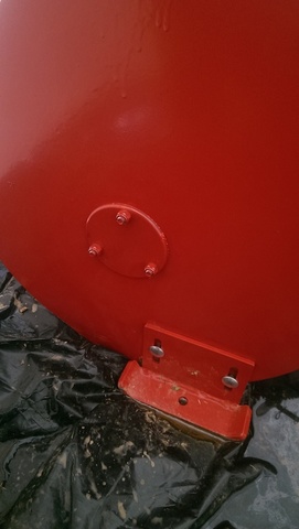

WVHillbilly520H
The skid shoes were also made by me the P.O. had let the others set in mud and salt to long, plus I made them wider and thicker than original,Jeff.

When I rebuilt my two-stage, I used the same cam-lock bearings CTBT&D used on his auger shaft.  Worked out just fine.  I would recommend them.  And yes, the 1/4" spacers are needed.  The bearings are not expensive and will be easy to replace if the need ever comes.

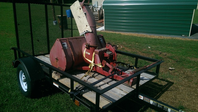

Did any of you guys take pictures of  apart and during assembly?  I  am only asking because I don't have a 2 stage to look at, yes, I bought a 2 stage, but it hanging out in a barn up by Kurt NEPA. LOL still haven't figured our on getting that yet either. I need a trailer is what I need.

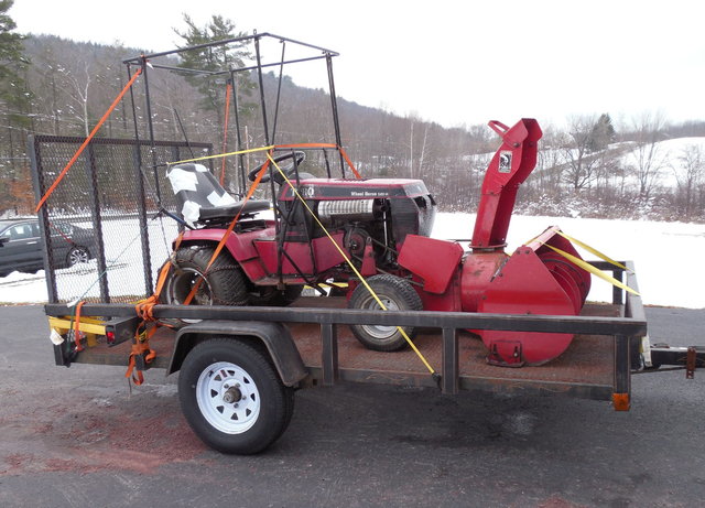

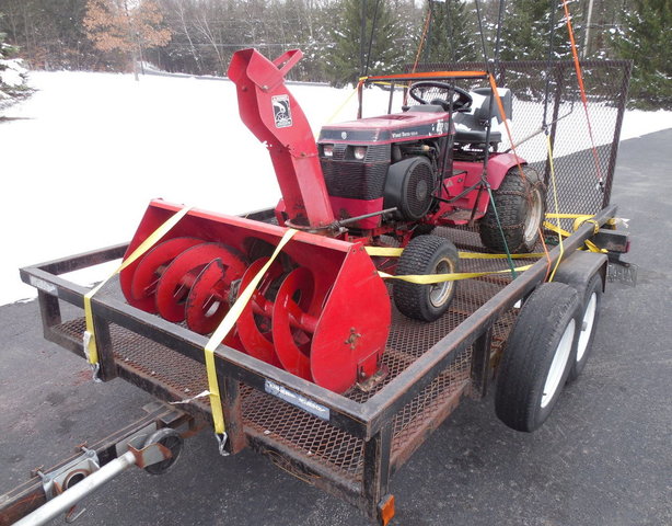

Kurt-NEPA
Glenn, I have lots of pictures of my two stage.  Too many to post.  I'll have to up load them to Photobucket and send you a link.  Here is a picture of my 93 520H. Cab, and two stage when they followed me home.  The trailer is the 6 X 12 I had to your place last year.  I rebuilt the two stage and cab.  Did a lot of work on the 93, but engine was shot - so I sold it.  It had 2600 hours on the Hobbs meter and still mowed my lawn for a year.  And that Hobbs meter had quit years ago.  Once the sun gets up, I'll find a tape measure and get length measurement for you.

Some dimensions Glenn,
Two stage mounted on a 520H - overall length - 98 inches, just over 8 ft.
Length of the two stage alone - 53"
Width of the two stage, skid to skid is 48"
Height of the tow stage is 48"

3.  I went with stock cam lock bearings on the auger shaft instead of the original bushing.  The hard part of that is you will need a 1/4" spacer on the inside of the end plates.  This moves the bearing inboard enough to clear the end of the shaft.  That 1/4" spacer needs to be fabricated. I did mine on a milling machine with a DRO, that really helped, but I could have done it with hand tools.  The hard part is the 2" diameter hole to clear the bearing.  Also,  a new set of holes will need to be drilled on the end plate. Here is a drawing of my bearing spacer.

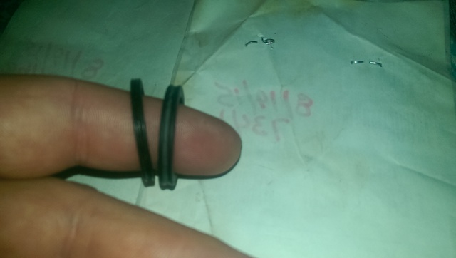

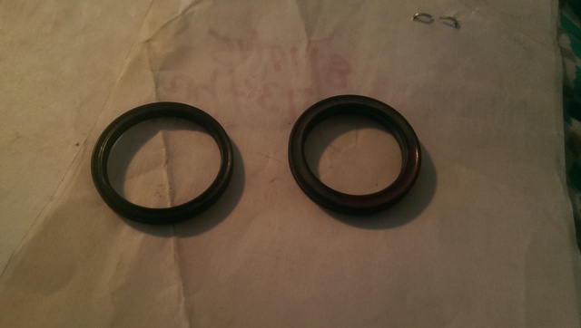

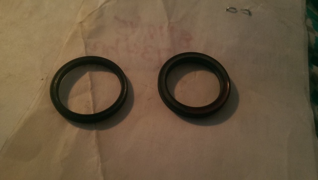

Ok back to the blower rebuild I know I have receipts somewhere, but for the bearing retainer/flanges I used TORO part #'s 110568 & 110567 zerk relube on the auger with 1" relube collar locking bearings from the "big bearing store" and fabbed up the 1/4" spacers and end caps at work in the machine shop, also at work I made new bronze oil lite bushings for the gearbox( which BTW is the same as their big walk behind blowers and in the 36" tillers also),then when the new Toro "quad seal" showed up it wasn't no different from the original I went hunting in the hydraulic seals at work and found 1 which IMO is a much better seal for the gearbox(hasn't leaked yet) a new case gasket and synthetic 75w90 gear oil, and my impeller was all bent and tweaked also from ??? which I straightened and added the rubber paddle kit, then replaced the rusted stuff roller chain (sprockets were fine),and a new nylon tension block, new drive pulleys(wish I had used TORO there), and then the new skid shoes sandblasted and painted except for the auger(ran out of warm weather) and the chute with the solid stone deflector from my single stage, then installed on my anniversary 520 ready for the snow,Jeff.    Pics of the "quad seals" the smaller Toro OE brand on the left which fit loosely on the shaft and in the gearbox case recess vs the hydraulic "quad ring seal" which fit snuggly on the shaft and in the gearbox case recess...
