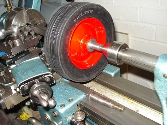

Just bumping this to say that the bolts are now finished and fitted.....   with Pics !!. measuring the Plain Shank length with the Old Bolt  laying on the Bed Ways-

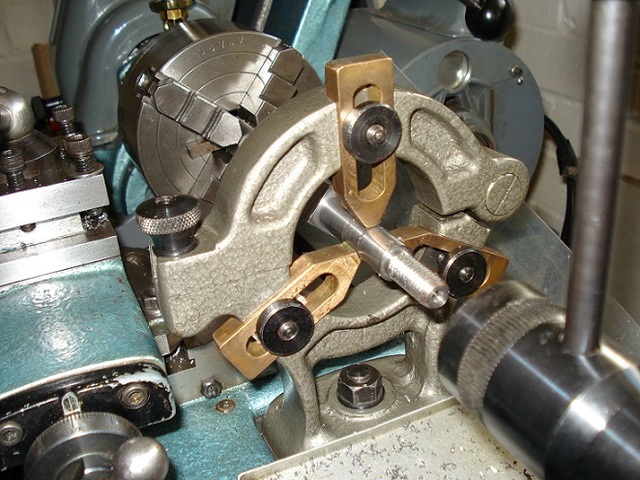

Started the 3/8" UNC Thread by Screwcutting and finishing with a Die-

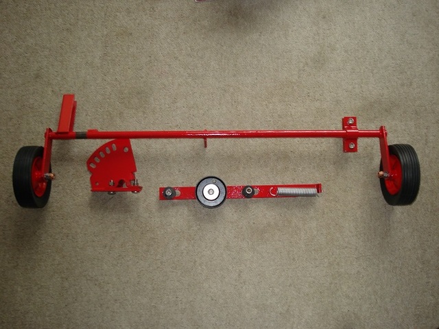

All done ready for fitting-
