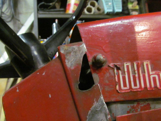

this hood don't seem to line up on the strg tower right . the notches ( picture ) on the tower seem wallered out anyone tried to fix them ? I have access to aluminum welder may try to weld it up and die grind it out ? anyone have a picture what they are suppose to look like?  also on crossbar latch on hood my old 857 has another set of rollers on it this don't. this c series that the way it is ?

That looks pretty far off. Check your hood stand at the base. It may be cracked.

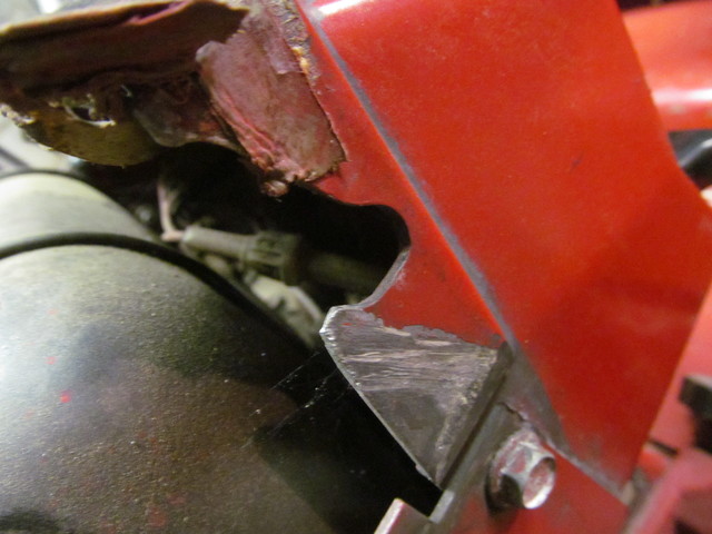

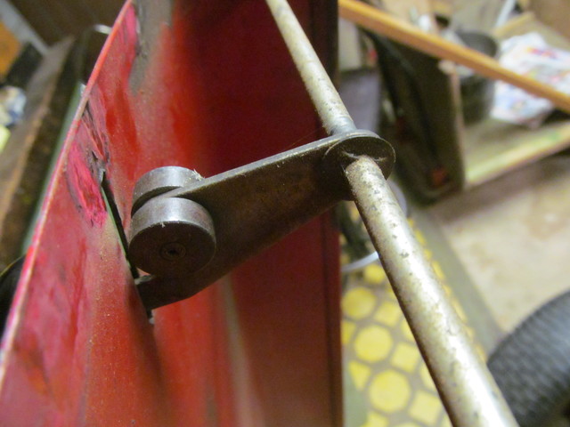

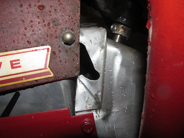

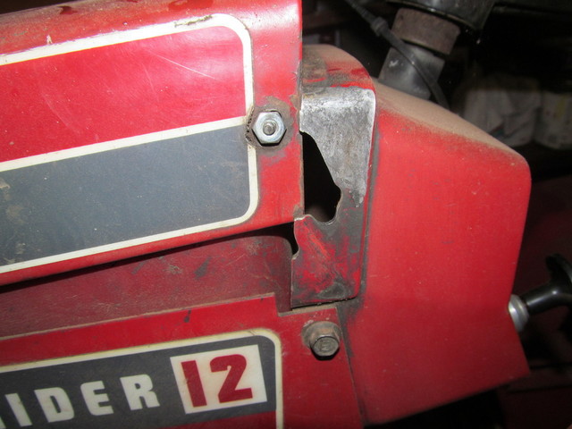

Here are a couple pics that may help.  Most of mine are worn pretty bad also.

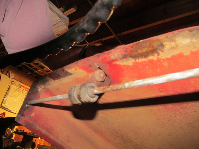

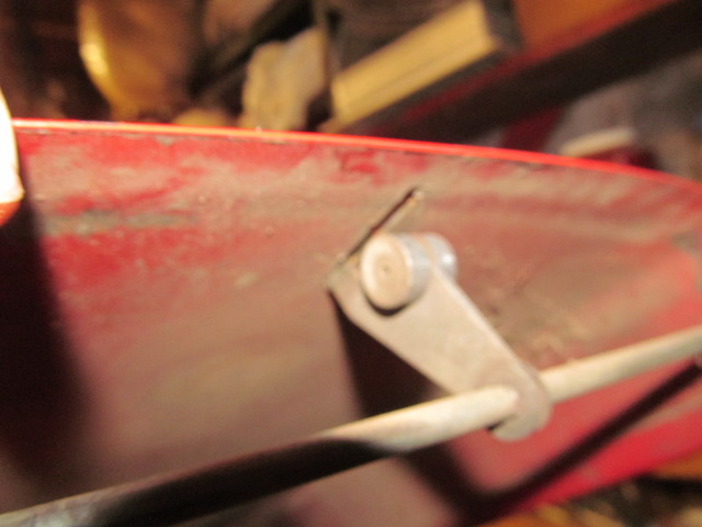

    BTW, your rod should have a spring washer retainer on both sides of the hood lever to keep it centered.
    C-120   has rollers at the top that pinches the hood to the stand.   Also has some misalignment.
   The 875 has also has rollers on the rod.  Not sure what they do except keep the lever centered.

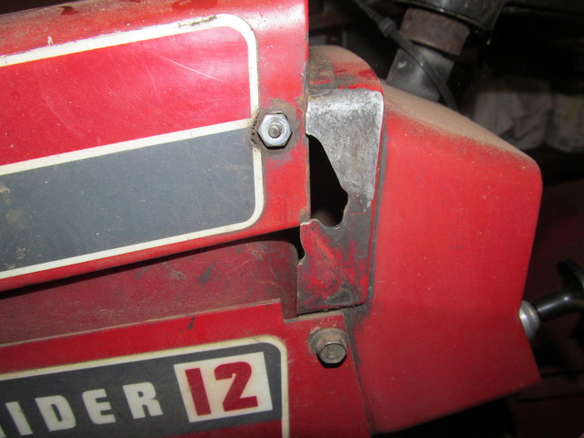

   The raider 12  has single rollers.

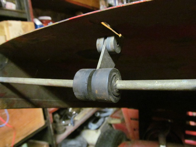

So, it looks like the short frames had rollers on the rod that don't appear to do anything but help to keep the lever centered,  and they were eliminated on the later long frames.
I don't think the shape of the notch is critical as it appears they are only there to provide clearance for the rod.  The small rollers that slide under the hood pull the hood down to the stand are what locks the hood.

looked at it real close no cracks .looked at the front and the hood looks square to the axle. the hinge rod has more wear on one side than the other.it has been hit on the right front but overall the hood looks square with the machine. thought about slotting the holes where the hood bolts to hinge for some adjustment

I personally believe the shape of the notch plays a part  in how tight the rod and rollers pull the hood down.Mine was worn
quite a bit, bought another one and one side was not worn much. Had my original one welded up, made a pattern of the
good notch cams used it to shape the welded area. Holds the hood nice and tight. Would never hold it tight before even
with a piece of rubber glued on top.
