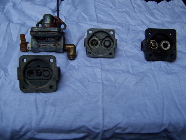

It sounds like he is talking about the check valves, I have never taken a plastic pump apart, but they may be using plastic check valves too. A picture could be help-full. I have a used plastic pump in the shop, Ill take a look at it in the morning.

Well I opened up the plastic pump as well as a couple of others. The plastic pump is on the right and has metal valves similar to the center pump which came off a 1267. The pump on the left has the primer lever (1965 and earlier) and the valves are quite different. Diaphragms on all three were the same.

The one on the left is the easy type to fix. Remove the springs and discs, clean them and the pump body, install the discs flipped over from original position.
