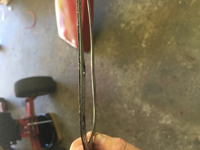

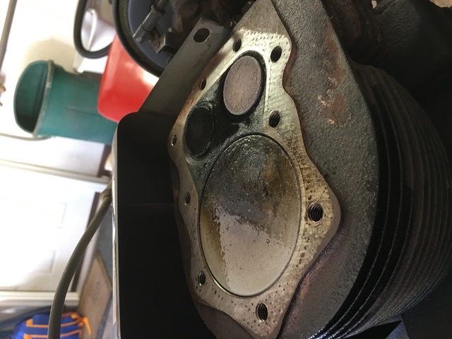

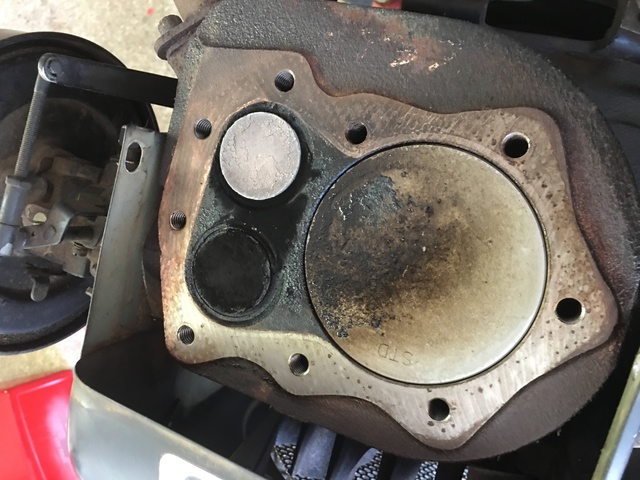

I'm guessing it blew another head gasket so I took the head off again. There's oil on the outside on the third fin down but I can't see and cracks or anything. Does this look okay to you guys? Also attached is a photo of the first gasket I put on. It looks like it came apart somehow.

One mistake that you made was using gasket sealer. Head gaskets should always be installed dry. Judging by the piston wash, (clean area on top of the piston) I would guess that your rings are probably worn. This would explain the smoking issue you are having. Not knowing how hard you plan on using this tractor I have two suggestions. If your not going to use it hard, put a new head gasket in then run a 50/50 mix of Lucas oil treatment and 30wt to keep the smoking issue down. If you plan on using the tractor hard then I would look at rebuilding the engine. These are my suggestions but feel free to get other opinions.

Piston wash is evident by the clean side of the piston, if no oil was coming through the rings the top of the piston would be the black color you see all the way across the piston. I would caution using oil additives or thicker oil as the dipper on the connecting rod will just slice through the thicker oil and not sling it around in the motor causing more problems. If I were to use and additive, I would as @achto says a mixture of 50/50 with 30w. Also I would sand the head flat before reassembly.

:text-yeahthat:Piston wash on a four stoke engine indicates oil getting past the rings and eventually washing carbon deposits from the top or the piston.

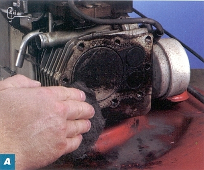

6 hours ago, Joeyd said:
Thanks
Notice the clean area on the surface of the piston.
 The top of this piston is covered with carbon, other than the spot that has been scrubbed clean. From the amount  of carbon on this piston I would say that there is nothing wrong with the rings on this engine.

Wear starts on the thrust surface first. Thrust surface would the front and rear of the piston. The sides of the pistons do not experience the amount of pressure that the front and rear of the piston do.When the cylinder fires the piston is forced down and forces the rod down and towards the front of the engine causing more wear towards the front of the pistons. Looking at the piston with wash, the front of the piston is cleaner because the rings are worn more in the front.
