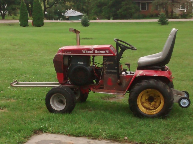

Crazy Wallace 3 #1 Posted September 22, 2016 I built a new hitch for my stock 14 hp 414-8. And I put 25 pounds on the front bracket and it hangs four feet out from my front and all it wants to do is ride the wheelie bars. How much more weight should I put on the front. I run the 1000 pound and 1050 classes. Share this post Link to post Share on other sites

Achto 28,576 #4 Posted September 22, 2016 (edited) Hi Wallace, I do some pulling with farm tractors. Figuring out weight can be a challenge, every tractor's a little different and you only get 1 or 2 chances at each event. If you have the weight to move I would double it on the front to start, then just keep adding until you find the sweet spot. Good luck pulling! Edited September 22, 2016 by achto 1 Share this post Link to post Share on other sites
jimt1971 237 #5 Posted September 22, 2016 Sounds like your hitch so to high. Many items go into how high the hitch should be. What do you pull on? How long is the chain from the sled? How high is the chain fastened to the sled. All of these item make a difference on how your tractor will pull. Once you learn how to read all of this you will be able to properly setup your tractor. 1 Share this post Link to post Share on other sites
Achto 28,576 #6 Posted September 22, 2016 1 hour ago, jimt1971 said: Sounds like your hitch so to high To me hitch height is important, I always run the maximum height allowed at the event. Any up pull on the front of the sled is an advantage. With this in mind, if the front of the tractor goes up your hitch height goes down. Best to have your set up so the front wheels just tickle the ground most of the way down the track. As jimt1971 said though many things affect your set up, even track conditions. Example : I will run more weight in the rear on a loose track, and more weight on the front for a tacky track. Track time and experimenting with your tractor is the only way to get things dialed in. You won't always get it right, but keep trying and remember your mistakes. Hope you get to crush some Cubs on the track. Share this post Link to post Share on other sites
Crazy Wallace 3 #7 Posted September 22, 2016 Most of the time I'm pulling on clay. My hitch is at 13 inches and hook point is 6 inches from the rear end. Thanks guys for the input And the shed chain is 36 inches long and hooked at the very bottom of the skid plate. It weighs around 5000 and it pulls like a tank. I'm hoping to get her dialed in to walk over the cubs. Before I built the new hitch she wasnt far off from the cubs. 1 Share this post Link to post Share on other sites

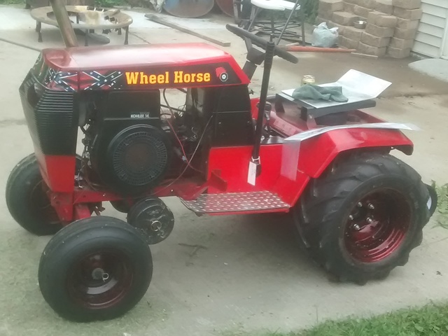

Crazy Wallace 3 #8 Posted September 22, 2016 This is what it started out like 2 Share this post Link to post Share on other sites

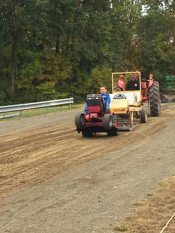

fast88pu 3,325 #10 Posted September 27, 2016 Check out the video of me pulling with my 312-8 on youtube. I have rear wheel weights and have to run with the deck attached. Im in the 1,100 lbs class and king of the lawn class. The video is 2016 montgomery ny tractor pulls 1 Share this post Link to post Share on other sites
