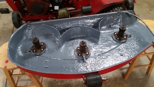

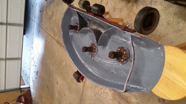

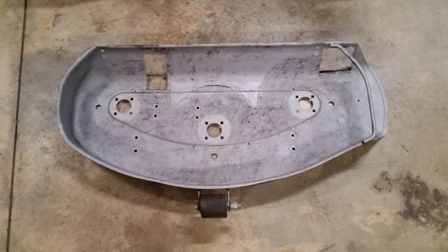

Cut the bad spots out and sandblasted the rl-426 mowing deck. Welded in new patches and new diverter wall.
Put Belzona (Metal and ceramic epoxy) on the underside of the deck. Primed and painted the outside. The
Belzona was pretty expensive so I only used it on the high impact/abrasion areas. The towers and the back side
of the diverter wall will be primed and painted to protect them from corrosion. Towers have new seals and
bearings. I bought new belts for it and all new hardwear. Should be ready by Wednesday for her first run in the
yard.
