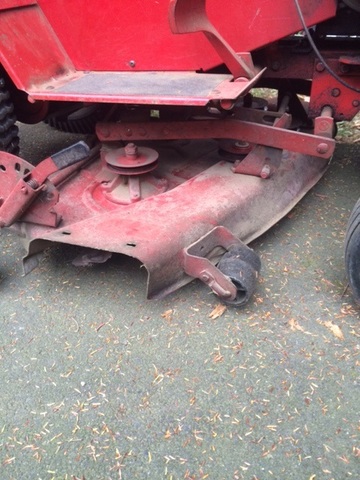

      I have a wh 308-8 I want to get into tractor pilling can I use this one please help a picture of it is below
