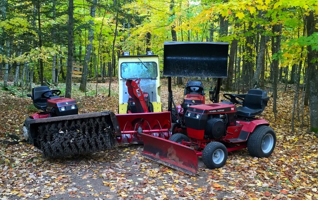

This is what I do:IMG_0471.jpg

I'm envious again...  Oh my TC35 with 74" blower and 72" FEL will handle the REALLY big stuff but a smaller FEL will get into some spots easier but what I really want is
THAT SWEEPER!  And I've got a BCS walk behind with a big rotary brush if I would just fix the mount...  BUT I STILL WANT THAT SWEEPER!
Really nice Snow Removal Team!
cheesegrader
The sweeper is great if there is no wind.  That is rare here in the winter.  It is great for getting the leaves and small sticks in the fall.
The loader is vital to deal with the deep drifts, and when snow sheds off the barn roof.  Those piles are really heavy, and nothing else can move them.

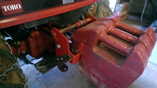

The plow gets about 200 lbs of weight on the rear wheels, and 60 lbs on the front.  It could use suitcase weights on the front.  Steeering in heavy, wet snow is a problem.
The thrower cab weighs 400 lbs, so I don't need any extra weights.  The rear cylinder vents onto my right foot, so I have never needed extra venting for heat.
I have to leave the rear window open most of the season to COOL the cab.  It has a wiper, LED lights, a defrost fan, and a linear actuator to control the deflector chute.
I would like to motorize the rotation as well, but for now I still use the old crank.
The heavy spring between the tractor frame and the thrower frame is essential let the thrower "float", which really helps steering.
Front Tri-rib tires also really help steering the beast.  I may get a set for the plow tractor next year.
All get 2-link v-bar chains, put on as tight as possible.  The rear ags on the loader get diamond pattern v-bar chains, rimguard filling, and 110 lbs each of steel weights.

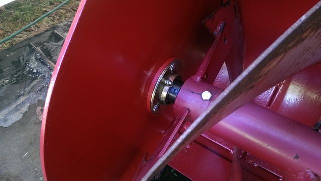

The tension block on the thrower has been replaced with an Idler pulley, and I would like to replace the thrust bearings on the augers with sealed bearings.
The tractors are '91, '93, '95, and '96 520's.  I like 520's. I can't imagine using anything smaller.
In case of emergency, I use a Ford 7000, but the 84" bucket is too wide to work around structures, and the cab is 9' tall, and catches on branches.
Go ahead.  Snow.

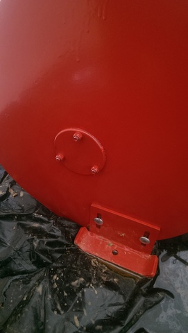

Cheesegrader, I did the locking collar releasable bearings (same as the single stage auger and impeller shaft bearing and holder) on my new to me 2stage last fall/winter had to make a 1/4" spacer for on the inside and a cap for the out side sealed with black RVT,on my bought new anniversary 520H with cab, now I have a couple more so it has been relieved to snow duty only, also my extra rear weights are fluid filled ags 75lb cast weights and a home built rear suitcase weight hanger approximately 130 lbs, and 2 link chains,Jeff.
