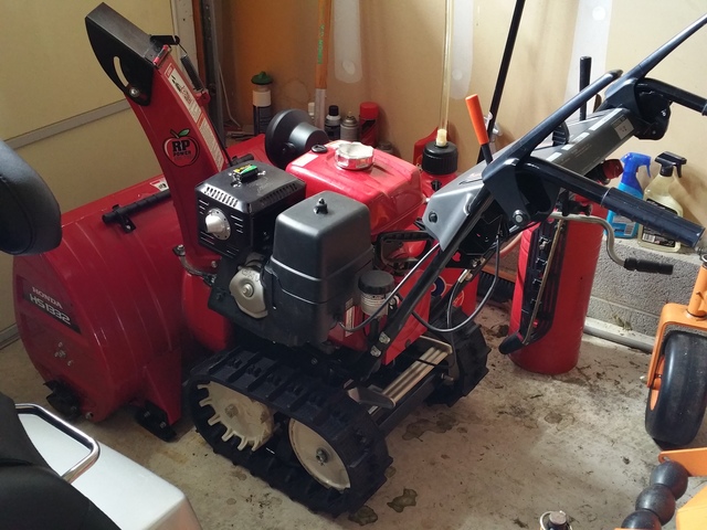

Like this one?

Glenn, I've always thought that the tracked blowers would be the ultimate but others have complained about maneuverability.  Some have said yes they have superior traction but end up climbing up the snow rather than into it.  Your experience?

Dennis, my experience is none. That was left to me by my brother when he passed. NOW HIS EXPERIENCE, was he loved it to the max, did everything and more it was asked to do. I tried it, it's all in how you operate it. You can get over zealous, and it will turn into a nightmare. Take your time, operate it as it should be. Further reports coming this coming winter.

It's SO hard to consider all aspect of a problem and its solutions.  What I THINK I gathered was that long driveways were great but back and forth and twisting was not so good.  Sort of like my big NH/74" blower vs a walk behind blower.  The NH can go through 4ft of snow in nothing flat but getting up to and into and around is not so handy!  So someone with a long straight drive in the country might give a tracked blower rave reviews but others in the city might not.  Same blower, but different needs and expectations of the operator...

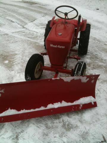

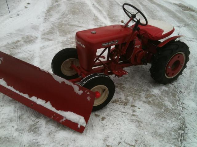

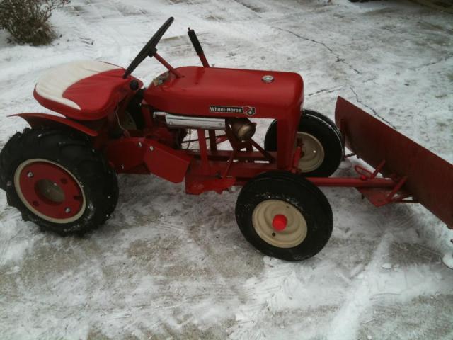

The "Best"  Wheel Horse snow machine?    Best in what way?  Best at making removing snow fun?  Best at turning over the snow and moving down out of the way?
I have to sat the reason I own  20 plus Wheel Horses today ( and three RJ's as of this writing) is the RJ Wheel Horse and the  42 inch snowplow that goes on this tractor!
Growing up with one we used it every winter.   Used chains on it back then on a gravel drive.
The original plow used on the RJ  had a curve on the blade that was not duplicated on the later Wheel Horse snowplows.
  It curved a little more and helped turn the snow when moving.
Now I know with a 3.5 HP Clinton, Kohler or 4 HP K 91 Kohler it was not a powerful tractor as the later models with bigger motors had but it was (and still is in my case) the best little snow moving piece of equipment that gave you an edge at getting to the removal early, enjoying the task  and being warmed by the heat of that motor throwing hot air your way once in a while!
Those that have done this know.

That is just awesome!  Maybe not quite up to one of our snow storms up here but sure is something to look at!  And with only a 4 hp warmer!

The RJ  worked the 1967 Blizzard  which had over 60 inches of snow in Northwest , Indiana!
You just had to keep at it.
