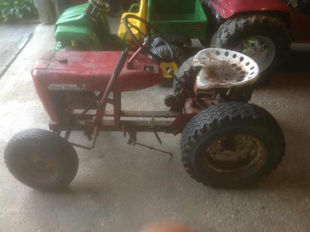

slim67 2,737 #1 Posted September 12, 2016 Well I picked this Suburban up early this summer and finally have some time and nicer weather to get started. I have the front half stripped down to the frame rails and wil be getting ready to do some sandblasting soon. I have high hopes for this one but not looking to build a show tractor. I want to use this one as a pull tractor around the yard and maybe whatever else I can think of. I respect the work and attention to detail of you purists out there( and it's phenomenal !) but I would enjoy it more by using it .Anyways I will post more pics of progress and thanks for a great forum to help me. Be back soon. 14 Share this post Link to post Share on other sites

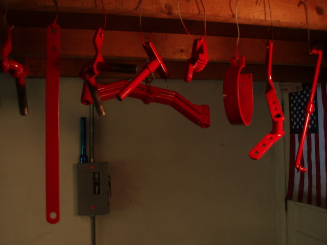

slim67 2,737 #9 Posted September 16, 2016 I started cleaning and etching most of the little parts and front axle and had time to paint yesterday. Here are some pics as it stands. I am well into it but have a ways to go though Im in no hurry. I will sandblast the hood,firewall,seat and probably rear wheels. Everything else gets the wire wheel which has always worked well for me. I know sandblasting is the way to go, but i have a 30 gallon compressor and it just wont keep up with the pot my Dad has ( an old TIP made in Canfield,Ohio). I dont know if I will take it somewhere, buy a smaller unit that will work with my compressor or what at this point.There is also a guy near me that dips parts in a caustic tank of acid or something. Anyways the wife wants something so talk to you all later and have a good day. 6 Share this post Link to post Share on other sites

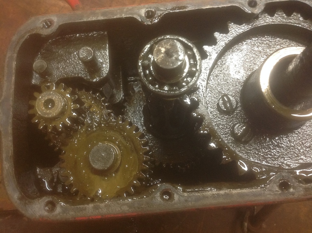

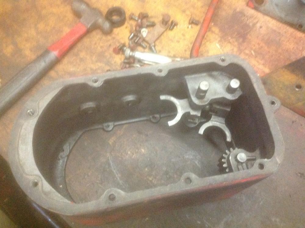

slim67 2,737 #22 Posted January 19, 2017 Well I took my trans apart tonight and it looks pretty good . Lot of sludge coating everything and a little water. I did notice some metal when scraping out sludge with my fingertips. I will post some pics tomorrow as I am beat. Overall I am happy with trannys condition compared to some I have seen on here. Lastly , I want to give a big shout out to Red Square for sharing all the info I need for the #5010.Thanks for your time. 1 Share this post Link to post Share on other sites

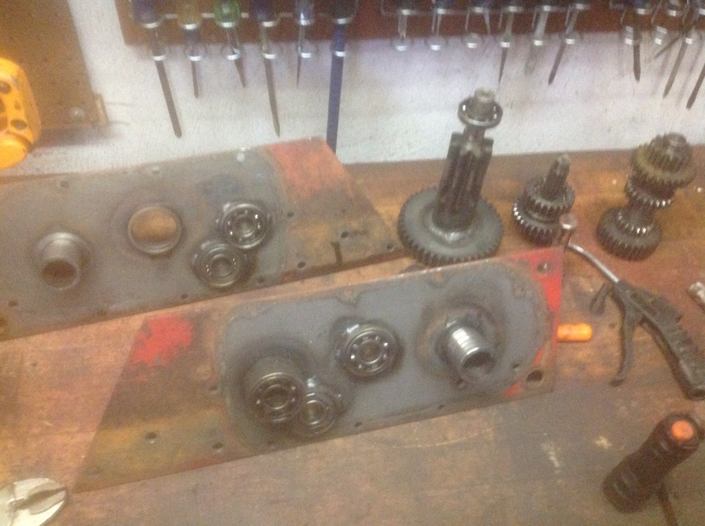

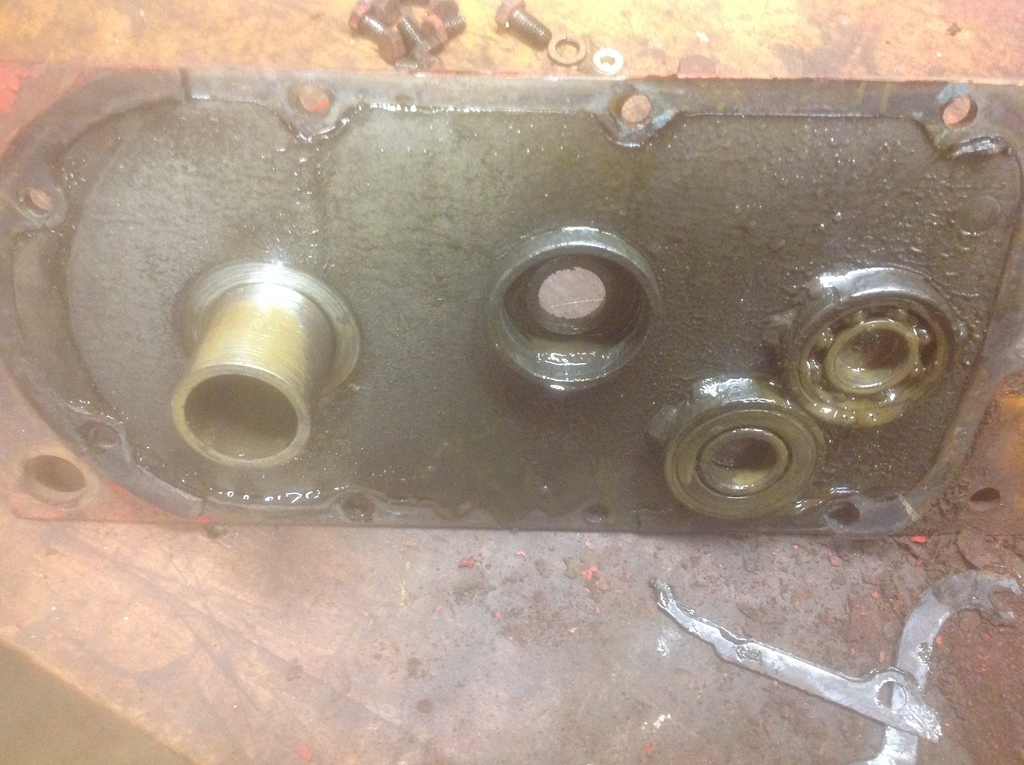

slim67 2,737 #24 Posted January 20, 2017 Here are some pics of transaxle. The differential is soaking in the parts washer so I havent really given it a good once over. As I said earlier, I was scraping out the sludge out into a drain pan with my fingers and could feel some metal bits. Fortunately there is no rust. Not bad for a 57 year old horse. I still have more to disassemble and clean but having fun doing it. I am dealing with back issues right now so I have to take break. I cant stand up for more than 5 minutes without excruciating pain in my left leg and am losing feeling in my lower leg and foot. Getting older and working sucks sometimes but Ill get through it. I have tractor to get ready for spring. sorry about pics, am having problems but could mods resize them please? Thanks 1 Share this post Link to post Share on other sites
953 nut 56,159 #25 Posted January 21, 2017 8 hours ago, slim67 said: I am dealing with back issues right now so I have to take break. I cant stand up for more than 5 minutes without excruciating pain in my left leg and am losing feeling in my lower leg and foot. Go get an MRI of your lower back NOW! Don't put it off. I was having those same symptoms prior to having spinal surgery, if I had done it sooner I wouldn't have had nerve damage to my ankle. I will walk with a limp the rest of my life, but at least I am able to stand and walk which I wouldn't have been able to do without the spinal fusion. Please, don't put it off, The longer you put it off the greater the likelihood of permanent nerve damage. Yours will probably look like this; the lower vertebra are pinching the sciatic nerve and won't get better on their own. Please, get it done, get an MRI now. 2 Share this post Link to post Share on other sites
