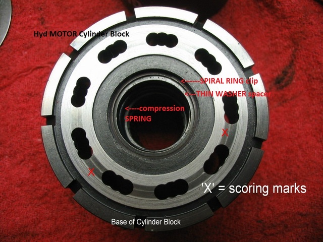

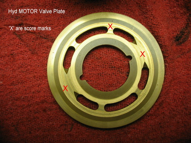

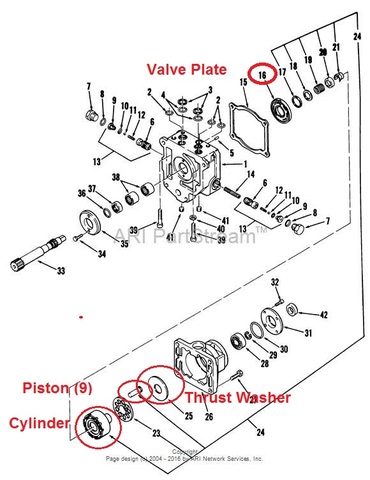

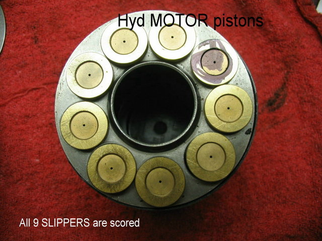

daveoman1966 3,850 #2 Posted September 9, 2016 I have rebuilt many of these Sundstrand units and USUALLY recommend a rebuild of BOTH the Hyd Pump and Hyd Motor sections. However, inasmuch as you declare the hyd lift works ok, you MAY be able to rebuild just the HYD MOTOR. It is attached to the trans gearbox and is far less labor intensive to repair than the Hyd Pump. It is very likely that the internal brass components of this Hyd Motor are scored / scratched/ gouged and need resurfaced leading to less power as the unit warms up. Let it be known that the internal components of the Hyd Pump are nearly identical to the Hyd Motor and, if compromised in one, the other is also bad. Ultimately the only sure-cure is to rebuild BOTH the Pump and the Motor. Here is the motor schematic. The red-circle parts are the brass components that take abuse and need resurfaced. I've also included a pic of these parts... 2 Share this post Link to post Share on other sites
