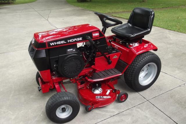

Im new to this site, been doing some digging for the correct mower deck for my wheel horse C-121. I'm having a hard time finding whats supposed to be under it. It has a newer deck under it but when its lifted the left front wheel rubs the left front scalp wheel when turning.

It sounds like you have a 37" deck designed for a 300 series with 6" front wheels. That deck is why they put the 6" wheels on them. You have 8" fronts. Post a picture and we can confirm that. Any 36", 42" or 48" from 1973 on will fit :)

I just fount a picture of the deck I'm talking about. Is this what you deck looks like?

Racinbob  that's exactly the deck that's on it currently.

There ya go then. That 37" deck baffled me a bit as to why they came out with it. I've heard it was great with a collection system so maybe that's it. As I mentioned, any 36", 42" or 48" from 73 on will work. Your horsepower is fine for any of them. :)
