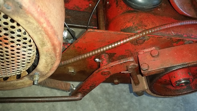

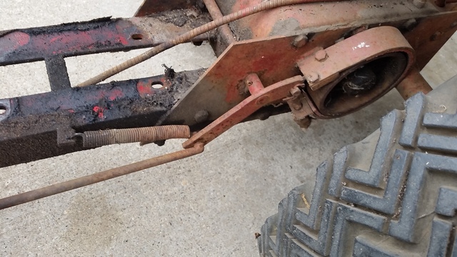

Hey guys still gathering parts for my Suburban 400 restoration.
I need the the spring or springs that actuate the brake/clutch rod?
Is there 1 or 2 and where can I get them?
Thanks
WHX??
My 400 only has one... should be able to get them at any hardware store
Wheel Horse # 1014 spring replaced by 83-2730
4.500" between hooks,
.070" wire,
.520" coil OD,
.380 coil ID,
3.570" coil length,
52 + 2 half coils
Garry
Racinbob
I used a Gardner Spring #37083GS from McMaster-Carr. Their number is 9433K111. I actually ordered them for the PTO on my 500 Special and found that they are a close match for the clutch spring on my Suburban 400. Another plus for me is that they are stainless steel. :)
