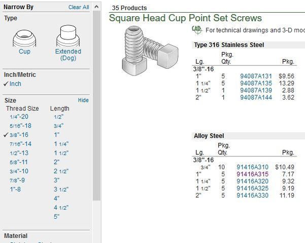

stevasaurus 23,086 #3 Posted August 22, 2016 (edited) Those are special bolts...they are indented on the bottom to better grab the axle without damage. They are actually a set screw...3/8 - 16 x 1". Suggest you get a 12 point socket that fits the 1/4" square head for more torque. Edited August 22, 2016 by stevasaurus 5 Share this post Link to post Share on other sites

Achto 28,806 #7 Posted August 22, 2016 You can also find set screws in 3/8 16 with an allen head on them. Then you can use a 5/16 allen socket on your torque wrench. 3 Share this post Link to post Share on other sites

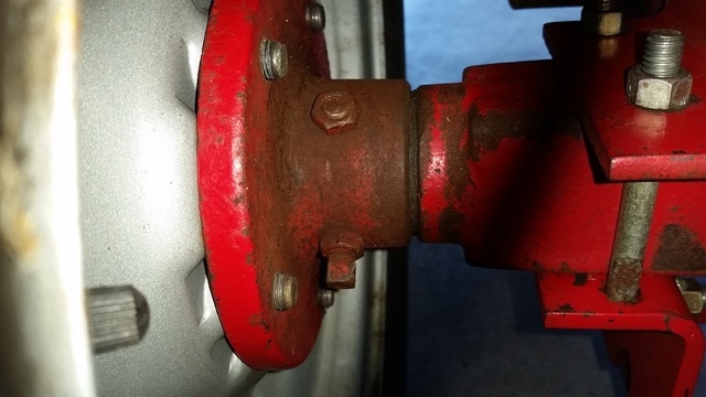

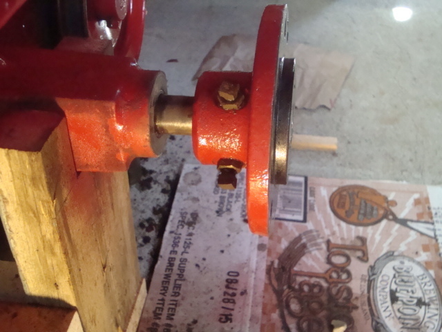

gwest_ca-(File Mod) 11,252 #9 Posted August 23, 2016 Set screw torque is listed in this manual and it is also on the first page that opens which is readable below. Just snug up the jamb nut. Any more and it tends to pull the set screw back out. After a few hours recheck the torque because they always seem to loosen as parts seat in. Keep checking until you are satisfied they are staying tight. Don't forget to apply Never-seize to the axle and hub. Garry Share this post Link to post Share on other sites
