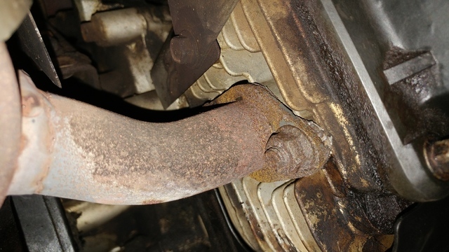

I am looking at possibly removing my exhaust to get at the engine better for cleaning it, and also maybe putting some high temp on the muffler.
It is pretty clear that the studs and nuts are VERY rusty, (funny, because the rest of the tractor has hardly any at all) and I am afraid they will not come of without a fight. Should I just leave it and deal with it as is? What is the process of fixing/replacing this were I need to remove the muffler?
It seems to run really well, so I don't want to dig into it too much, but I want to clean it up to give it a fresh start. There are a few broken off shroud bolts (how do you break those!?) that I need to get at and replace.

If your muffler is in decent shape, I would leave it. Otherwise, judiscious application of penetrating oil and heat. I have found a 3/8" drive impact driver works well on head bolts so may work here.
The Kohler Command has a tendency to backfire when shutting off. This can "crack" the muffler. The remedy is to shove the throttle to full while turning the ignition to off.
