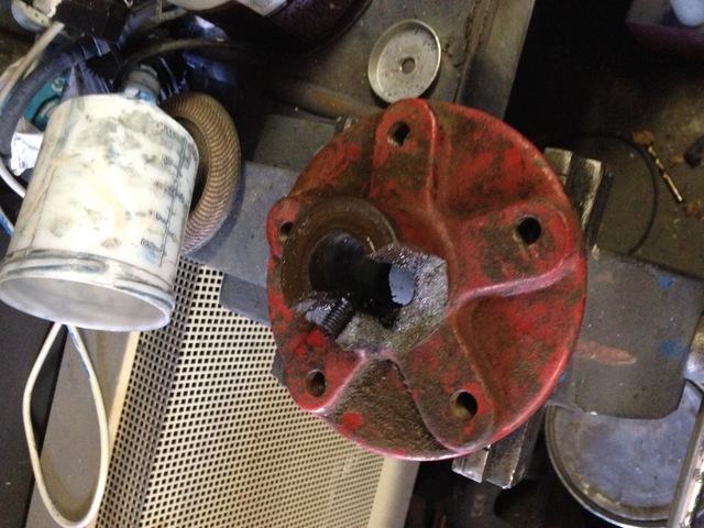

Hello i searching for a wheelhub for my wheel horse raider 12 its broke someone knows where i can buy a wheelhub ???
stevasaurus
Welcome to Red Square :WRS:   How did you happen to do that??  We have another member here from the Netherlands that may be able to help you out.  Koen   @C-101plowerpower   Hopefully, he will see this and stop in. :)  Please verify that your axle is 1 1/8" diameter...it should be as it is a Raider 12...but you never know for sure from over seas.   The other option would be 1".

We still need to know what size it is.  The hubs are like standard to fit the wheel rims, but are bored out to fit the 2 different axle sizes.  You don't want to buy the wrong size and get it shipped from the states.  You can either measure the inside of the hub, or the diameter of the axle..they will be the same.  :)
You should have the 1 1/8" axle for a Raider 12.

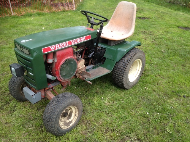

anyway, got any pictures of your horse? we do like pictures

i have pics posted on the main forum in the beginning i think

i have here a pic i'm searching for a better seat more original look

If that hub is less then 1", you are not going to get a hub from anybody on this site.  We only have 1" and 1 1/8" hubs.  :think:

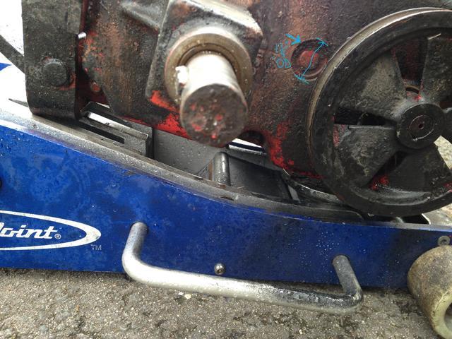

i gonne remove my transaxe and look of i can find a number of the type of axe

if you do, post a good couple of pictures of said trans, and from the axle the hub broke on, that hub didn't break by itself i'm guessing

OK...your tractor was made in Belgium.  That is a 4 speed transmission...does not have the hi/low.  All of the Raiders made here in the states have the transmissions that have the hi/low in them.  From the pictures in the line-up at the top of the page, your horse had a "4 speed" sticker on it before the green paint.  If you look at the list of Belgium Raider 12s, it looks like only one had the 4 speed transmission (#5080) would make yours a 1971 model #1-0310.  Check out this link and go to page 14.
See if you can find your model #...should be on the tower below the controls or on the side of the tower.  If your transmission is a # 5080, those are 1" axles.  :)  By the way...that #3900 on the side of your transmission in the picture above is the part number for that transmission case half for the #5080 transmission.
In the picture below, you see the axle on the left and the drive pulley on the right.  In the middle is a capped bearing #1532...that hole measures 1 1/4" Outside diameter...it is 1" Inside diameter.  Looks to me those axles are 1".

ikbendennis
that sits between the axe and the wheelhub?
stevasaurus
Right...see that little round indentation just left of the drive pulley.  That is a capped bearing, your 11/44 toothed mushroom gear has one end in that bearing.  That hole measures 1 1/4".  :)  Looks like that would measure 30mm.
