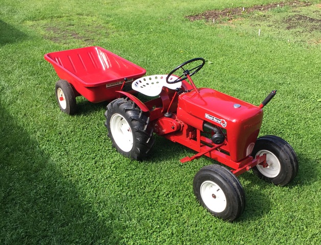

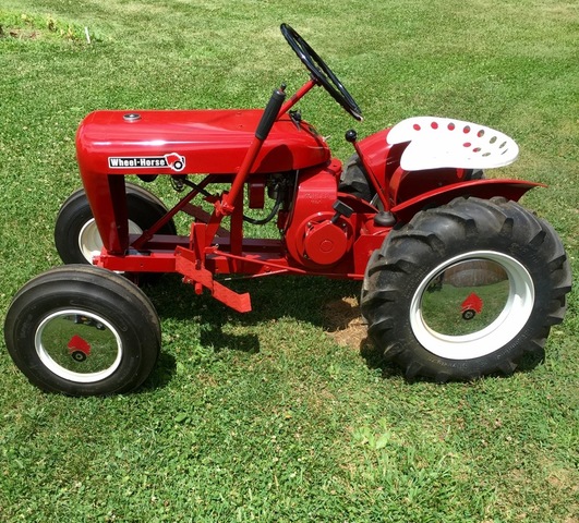

stevasaurus 23,017 #7 Posted August 2, 2016 Crazyhorse...you can call it anything you want...just don't call it late for dinner. I don't think anyone will argue with you with that casting date you have. Pretty cool really. It would be nice for you to post some pictures of this horse, and maybe add them to the gallery on the main page. 1 Share this post Link to post Share on other sites
crazyhorse1056 109 #8 Posted August 2, 2016 Thanks for the info 5 Share this post Link to post Share on other sites
WheelHorse79 271 #9 Posted August 3, 2016 Beautiful RJ! Mine must be an early RJ58 because it doesn't have a casting date at all. 1 Share this post Link to post Share on other sites
