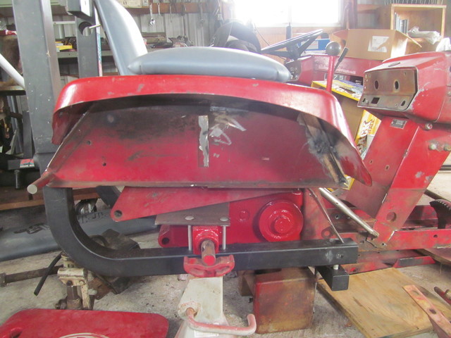

Ed Kennell 39,735 #1 Posted July 31, 2016 Looking at the load of parts I picked at the auction last week, I realized I almost had enough parts to make a tractor. I may have to buy another gallon of bondo to fix the hood. 15 Share this post Link to post Share on other sites

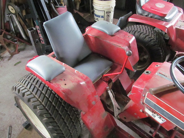

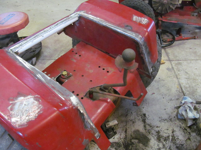

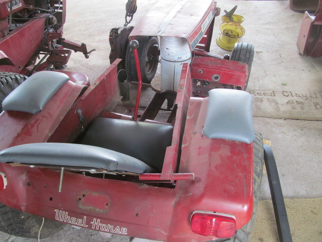

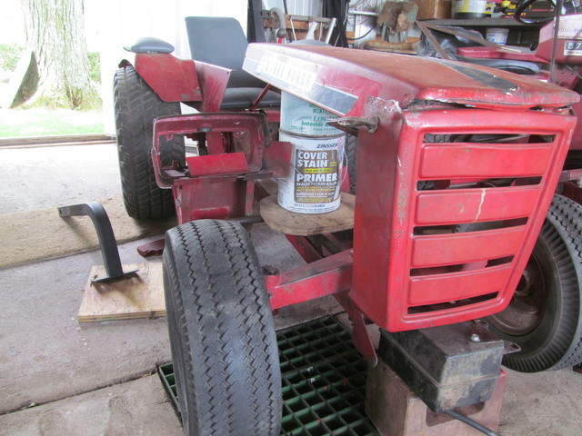

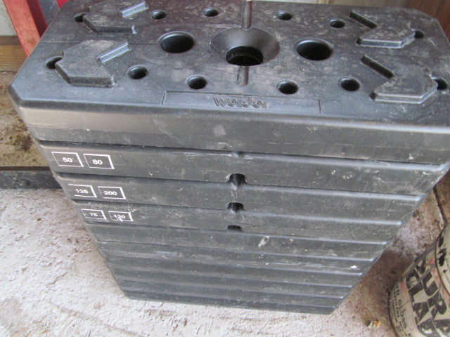

Ed Kennell 39,735 #7 Posted August 1, 2016 Got the seat bucket fit up and almost ready to fire up the mig. T I want to lower the hood more, but I need to select a power plant first so I have enough room. I'm torn between a free Briggs 7 and a $560 HF 22 twin. That old weight trainer I bought for $5 to get the 10 - 25 lb weights will make a pretty nice roll cage and seat pads. 10 Share this post Link to post Share on other sites
AMC RULES 37,144 #8 Posted August 1, 2016 Shouldn't the rollcage dictate... using the 22hp twin. 6 Share this post Link to post Share on other sites

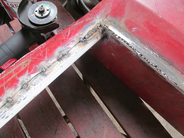

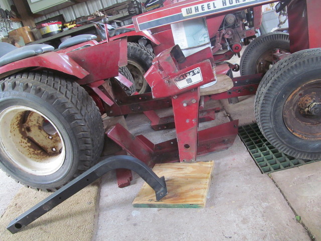

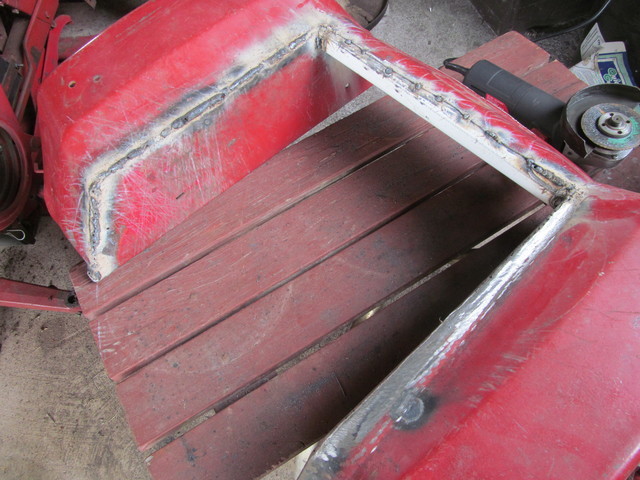

Ed Kennell 39,735 #10 Posted August 9, 2016 Got the fenders welded and ground up today. Think I have the cage mount figured out. Now have to get an engine before I can fix the hood height. 10 Share this post Link to post Share on other sites

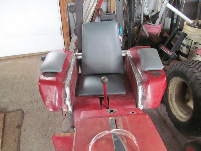

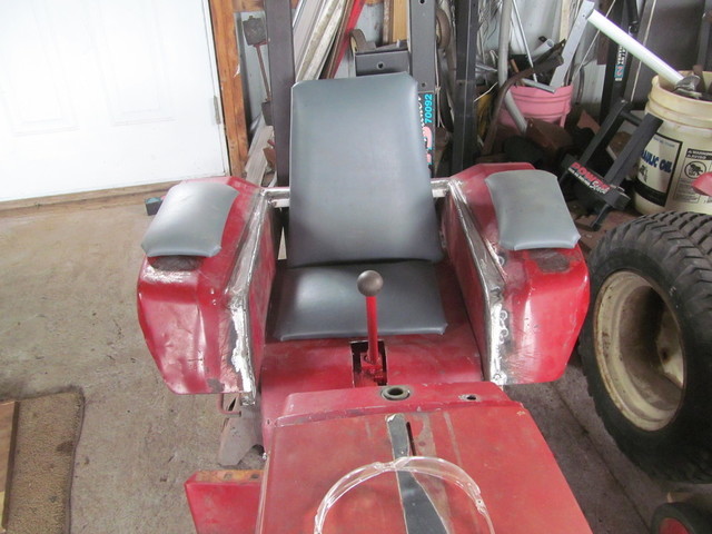

DennisThornton 4,770 #11 Posted August 9, 2016 Well, looks like I'm going to have to "Follow" this! 3 Share this post Link to post Share on other sites
953 nut 56,742 #12 Posted August 10, 2016 Padded arm rests! 4 Share this post Link to post Share on other sites
ACman 7,629 #13 Posted August 10, 2016 I likey!!! ... I just fell out chair , that thing is going to be and your wondering what engine you should use ! 4 Share this post Link to post Share on other sites

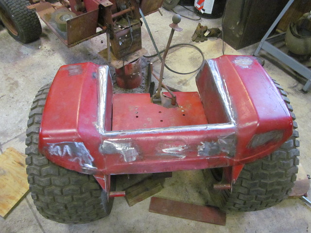

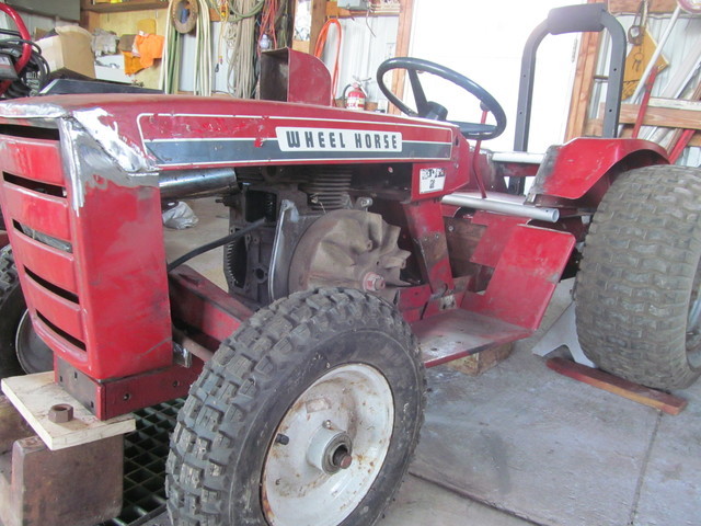

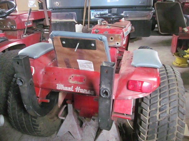

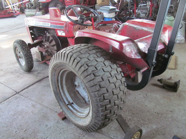

Ed Kennell 39,735 #17 Posted August 23, 2016 Got all the major parts pretty much in position. Got the front axle and steering figured out. Still need to get an engine and build a clutch. 9 Share this post Link to post Share on other sites
19richie66 17,542 #18 Posted August 23, 2016 That looks very cool Ed! I like the way you chopped the grille. Share this post Link to post Share on other sites
953 nut 56,742 #19 Posted August 23, 2016 Ed, it is a good thing you are so slim, several of us couldn't get out of that seat, I like the hood scoop, the ram air effect should be good for high speed crusin. Share this post Link to post Share on other sites
elcamino/wheelhorse 9,360 #20 Posted August 23, 2016 Ed , what size engine are you going to stuff in there? Have you made provisions for a 4 pt seat belt ? Share this post Link to post Share on other sites
953 nut 56,742 #21 Posted August 23, 2016 14 minutes ago, elcamino/wheelhorse said: provisions for a 4 pt seat belt ? Don't forget to make provisions for a chute! Share this post Link to post Share on other sites
Ed Kennell 39,735 #22 Posted August 23, 2016 45 minutes ago, 19richie66 said: That looks very cool Ed! I like the way you chopped the grille. That hood was on a wrecked Raider Richie. The hood and grill were folded together at the headlight opening when I bought it, so It was a good candidate for a chop job. I just cut out the wrinkled area and welded it back together. 32 minutes ago, 953 nut said: Ed, it is a good thing you are so slim, several of us couldn't get out of that seat, I like the hood scoop, the ram air effect should be good for high speed crusin. If I don't lay off the pies, I may not fit either. Pretty easy to cut the back panel and move the fenders out for wider bottoms....if necessary. Not sure the ram will give me anymore HP, but if I go with a big K series, the scoop will cover the spark plug that will be sticking thru the hood. 29 minutes ago, elcamino/wheelhorse said: Ed , what size engine are you going to stuff in there? Have you made provisions for a 4 pt seat belt ? Haven't decided yet Jim. Kinda waiting for something with some HP to show up. Yeah, I have some ideas for the 4 point and a seat ejector. 17 minutes ago, 953 nut said: Don't forget to make provisions for a chute! Got it Dick....check post #16. 1 Share this post Link to post Share on other sites

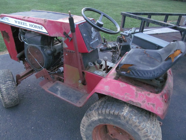

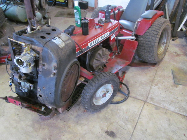

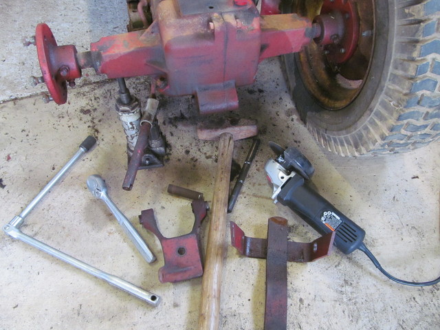

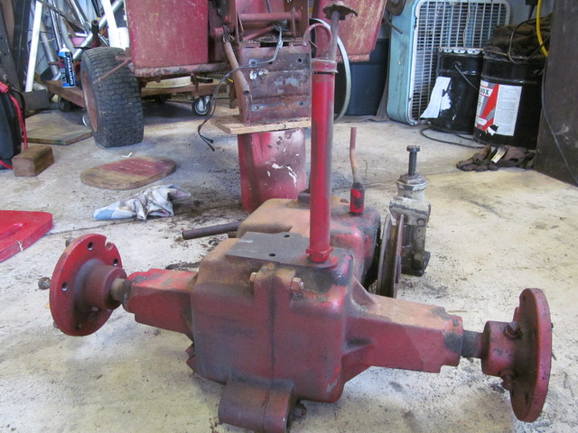

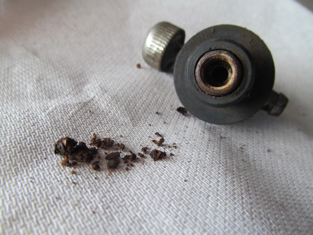

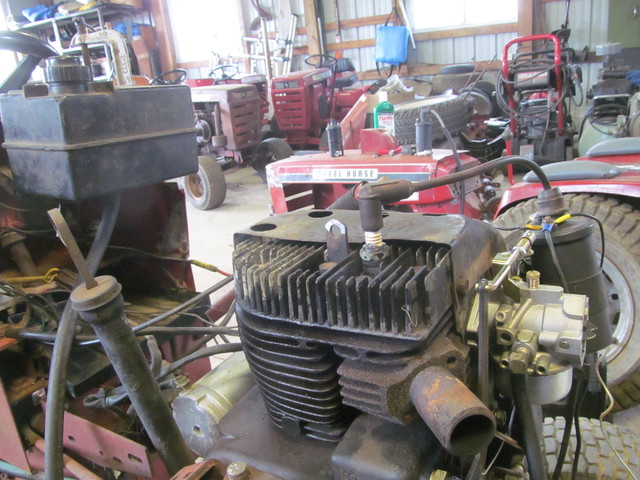

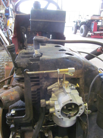

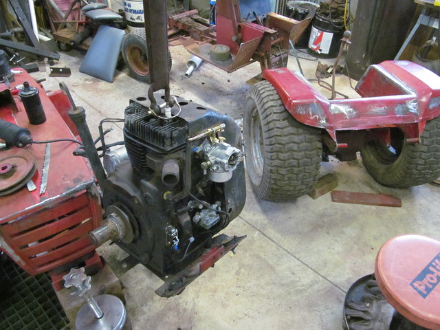

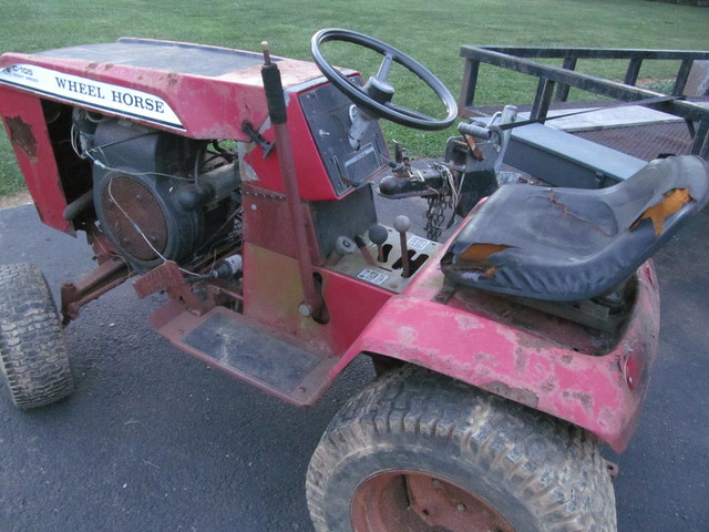

Ed Kennell 39,735 #24 Posted September 28, 2016 Hard to believe It's been 2 months since I worked on this project. I got the boat winterized and put away for the winter this morning so the low rider project got some attention this afternoon. I had bought a non runner C-105 a few weeks ago just for the 8 speed for the LRer. It actually had a K321AS transplanted that the PO said hadn't run for years. After chasing grounds or lack of grounds for quite a while, I finally got fire and got it running by hand feeding fuel in the carb. This is what I found in the totally plugged tank shut off valve. It has a Walbro carb, so I didn't even check it out...just bought a new one from the jungle for $35. I hooked up a high temporary tank and It starts and runs perfect with no smoke, so the 321 is going in the LRer So this afternoon, the transplant began... The first job ...not my favorite...was to remove the hitch from the 8 speed. Then remove the 8 speed. Fit up the seat pan and fenders. Then Pulled the engine out of the C-105. Man I hope I can stuff that under the hood! That's all for today folks....Mrs K is calling me for dinner. 8 Share this post Link to post Share on other sites
953 nut 56,742 #25 Posted September 28, 2016 The shift levers will be a bit cozy! Don't stop too fast. 3 Share this post Link to post Share on other sites
