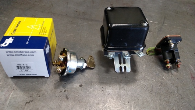

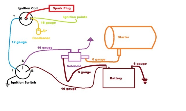

TIGman 2,006 #1 Posted July 30, 2016 Time to get serious with the 875. Parts all arrived this week... NEW Cole Hersee Ignition switch Voltage regulator Starter solenoid Going to make use of the wiring diagram 953 Nut provided and see if I can get the 875 fired up this weekend. 3 Share this post Link to post Share on other sites
cafoose 3,355 #2 Posted July 30, 2016 My 876 was burning out ignition switches and I did the same thing a few years ago and now it works great! Share this post Link to post Share on other sites
stevasaurus 22,869 #3 Posted July 30, 2016 TIG, put some numbers and some more information in here, and we can put this in the "Reference" Section. Share this post Link to post Share on other sites
ol550 830 #4 Posted July 30, 2016 23 minutes ago, stevasaurus said: TIG, put some numbers and some more information in here, and we can put this in the "Reference" Section. Even throw in the generator and regulator wiring to have it all. 1 Share this post Link to post Share on other sites
