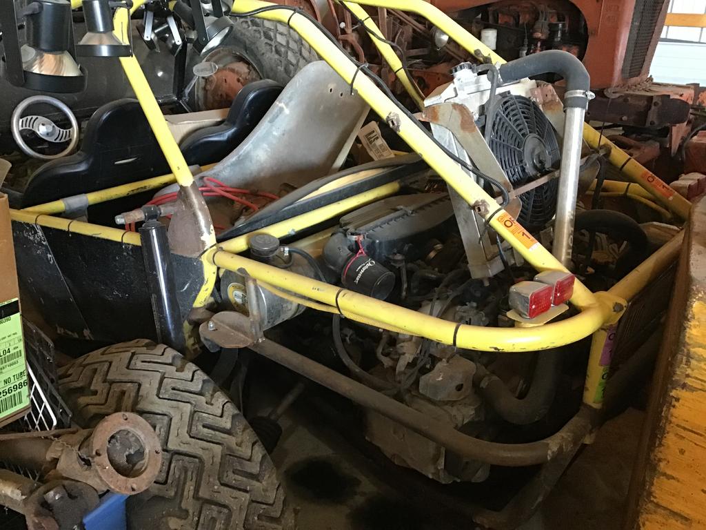

Pullstart 64,582 #12 Posted November 5, 2017 (edited) Well, after having this car about a year, almost the only thing semi-original is the chassis and that'll soon change too. I'll be attempting to stretch the wheelbase 11" and build a more rigid cage as well. It's now got a Subaru 2.5l non-turbo engine, longer travel front and rear and more upgrades on the way. here's a link to a VW forum with my build page: https://www.thesamba.com/vw/forum/viewtopic.php?t=662104&start=0 Edited November 5, 2017 by pullstart added picture 4 Share this post Link to post Share on other sites
AMC RULES 37,146 #13 Posted November 5, 2017 Really, why 11" longer? Share this post Link to post Share on other sites
Pullstart 64,582 #14 Posted November 5, 2017 @AMC RULES there's no legroom for the rear seat.... maybe 5-6". Appletree's new frame is 11" longer wheelbase for that reason. I damaged the top of the rollcage bottoming out in the dunes (compression/stress fracture at some joints) so the top half needs some redesign and gusset work anyways, might as well make it fit 4 people like it should with decent seats to boot. I'm sure the added weight won't slow it much, I've nearly tripled the horsepower with the EJ25 swap and fuel injection. The wiring of the project was the most satisfying part... that it actually fires and runs well after all the hacking of the harness! Share this post Link to post Share on other sites

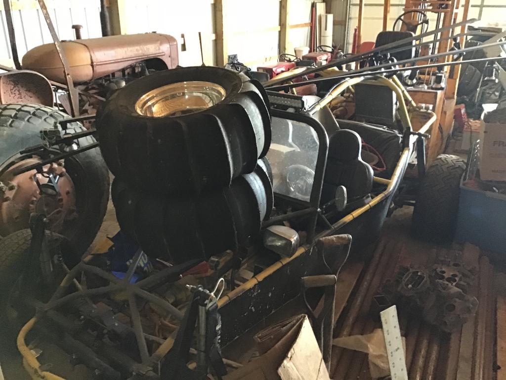

Pullstart 64,582 #16 Posted September 5, 2019 Long time, no post updates on the buggy. Last fall, the EJ25 Subaru engine started knocking. It never was run low on oil, but it was also treated like a toy. A toy that likes a good flogging. For clearance, the oil pan was shortened a couple inches but even with a skid plate that pan has kissed the ground a few times. Not too long before that, a second cousin had fallen on hard times and needed a car. We purchased a Forrester that needed an engine and I used my best back up engine to get her some wheels on the road. Now she has acquired a van that is better suited for her needs and she decided to return the Subaru to us. Now, I’m in a conflicted bind... There’s nothing mechanically wrong with this car, but the buggy has been waiting patiently for new life. What to do.... what to do. I’ve often thought about adding a turbo, the donor engine is a lower compression EJ22 and apparently the stock ecu is known to respond well to 5-8 psi of boost without additional tuning. I would also plan to build a 10 degree mount on the trans for additional rear ground clearance. I also have a second Honda half-rad new in the box and would completely upgrade the cooling system. yes, I need one more project, as bad as I need another hole in my head. this car is a blast, but for some reason I don’t need to explain to y’all, these tractors are a blast too. Share this post Link to post Share on other sites
