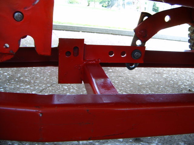

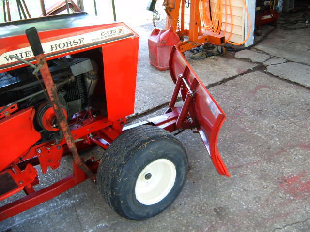

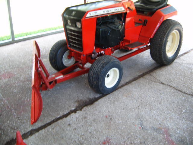

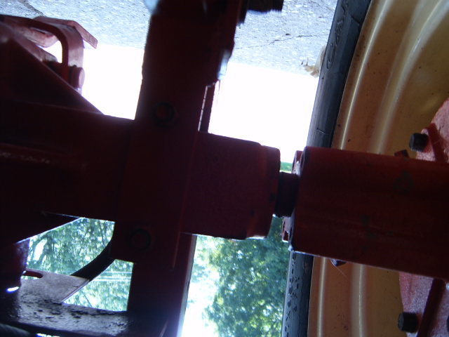

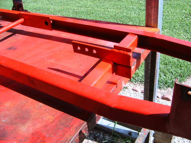

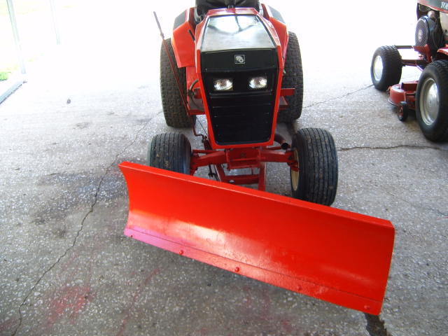

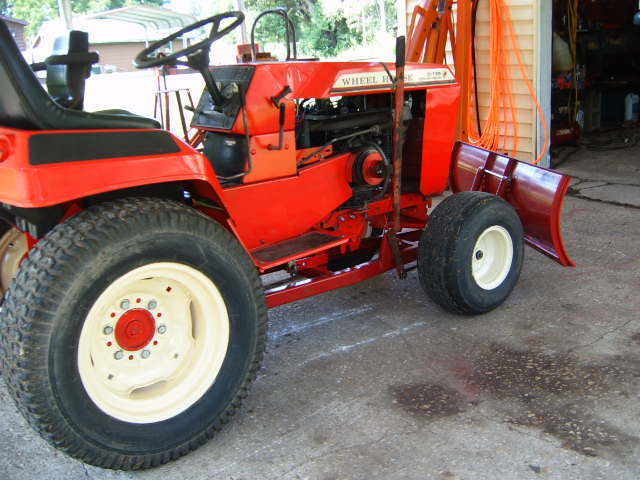

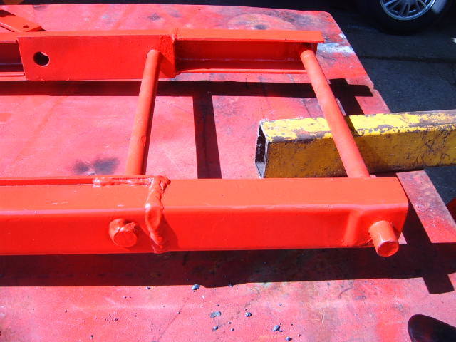

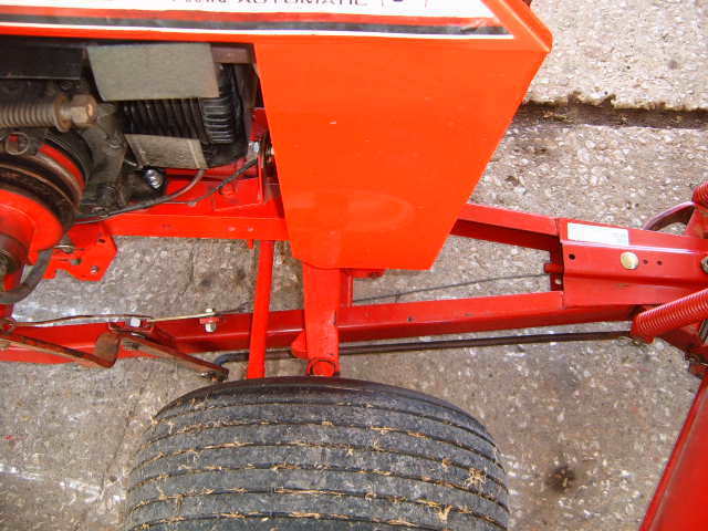

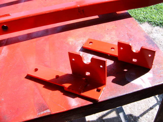

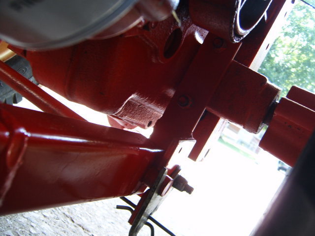

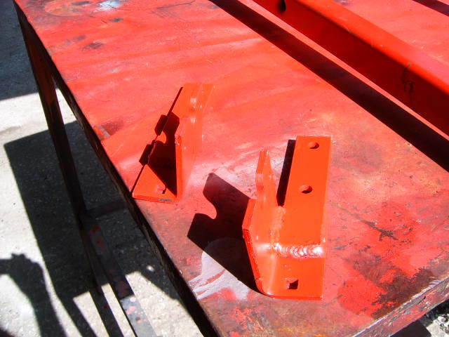

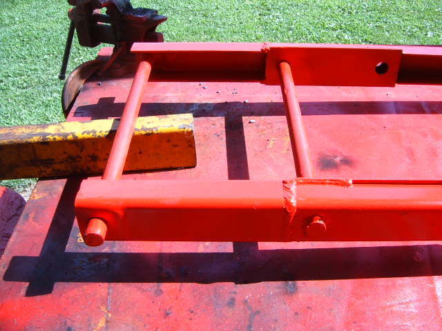

 Many of you may know last year I made a fully hydraulic blade for this tractor, but a friend wanted it so after a trade , I was blade less for the C195. So here is a fully manual blade. had to extend the A-frame  6in. and cut the angle rod of to make it so you could reach it sitting down. Also had to modify the lift bracket and make new brackets for the rear end.
