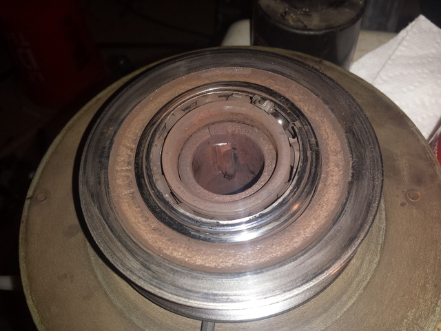

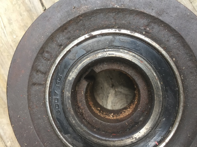

My daughter was using the Wheel Horse rider to mow, I was push mowing. She drives over to me and says, "Dad, the blades aren't turning." I look at the mower, she's got the blades engaged (lever forward) but nothing is moving. I disengage the blades, and re-engage... nothing. No movement from the belt nor clutch. Then I notice the smell, and look closer, the belt is so hot is melting on the clutch. Or rather, the clutch is so hot it's melting the belt. Melting occurred.
While the clutch is disengaged, I can spin the clutch freely; and whilst it's engaged, it won't move.
So, what did I do now? Peter told me to lube that needle bearing, but I couldn't find a write up/how to anywhere, so I was putting it off until after the leaves were done falling in the Fall. I haven't taken anything off yet, other than the pins that hold the pinion and such, and the little brake pad. I see there are two snap rings, assume they come off, and then the assembly slides out as a whole?
Some pictures of the clutch, can anyone tell if it's usable from them?

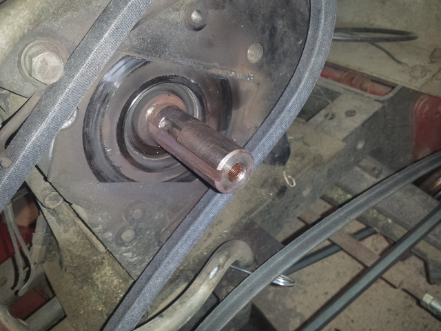

Need some help. My 800 Special has an electric PTO. It is not working. Checked Ohms - nothing. My questions are 1) how does the PTO come off and 2) can they be rebuilt? I took the bolt out that I thought holds it on but no luck. Must be something more?
