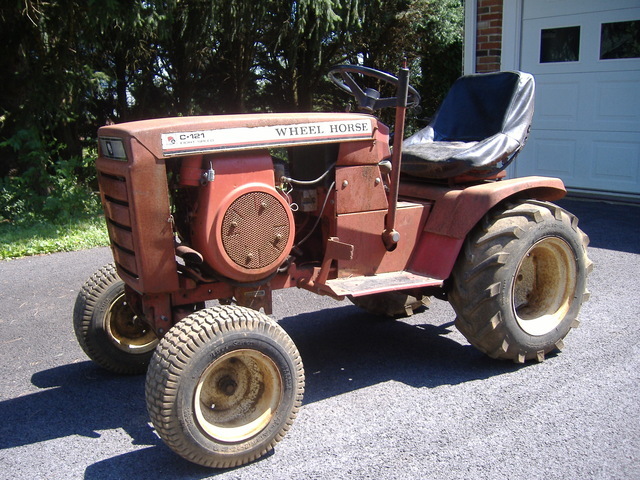

My 1979 C-121 project is coming along pretty well....so far.

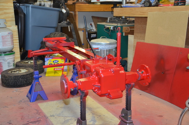

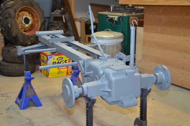

Got it down to the bare frame (naked horse in my garage) degreased, got it down to bare metal, two coats of primer, sanded and first coat of red on this am
thought I would start on the smaller parts first (a little too warm for the blast hood and long sleeves) rods, small plates and such.

My C-121.  Progress as of 7/17
