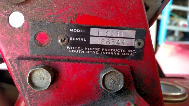

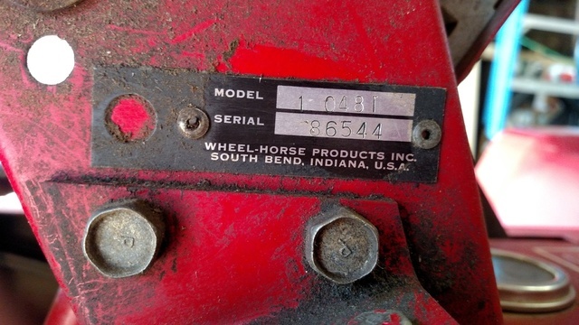

C160 Kohler 16 HP. Mid 70's model. I don't have model number of engine available as I'm at work. But it's the standard round coil +- posts with coil wire hole in center. Can anybody give me an aftermarket part number or the original part number and maybe I can do some cross checking. I have intermittent spark on a brand new set of points and condenser. Thank You! Bill
Image is the model number of the tractor to give you an idea of the year. Motor is original. Entire tractor is original as it was sold at our families dealership back in the day. I just acquired it last week.
