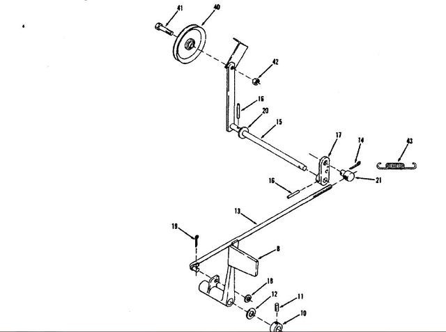

Anyone have a part number or know what the clutch pulley attached to the pedal to engage and disengage the belt is called? The bearing is done in the one on my 77 b-80 and I have tried searching online and haven't been able to find what I need or a part number...
pfrederi
  Do you mean item# 40??    Old # 7451 new 95-7668
bwcollins
You the man! Just spend the last two hours looking for that pic on the web and for some reason it wouldn't pop up, thanks
If you ever want one with a real ball bearing in it use a Napa 7-05485 or Stens 280-362.
