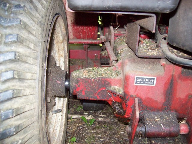

I have this SK-486 with 16 HP Kohler.  I noticed gap between rear end and wheel.  I have no manual but am in the market for one.  In the meantime, anyone know how I can fix this?  Thanks.

    There are lock screws in each hub that keep them secured to the axles.It looks like the right side needs attention also.The axle should not be sticking that far out.Raise the rear of the tractor and loosen the lock nuts and screws.Slide the wheel so that the axle is flush with the face of the hub.Retighten the screws and lock nuts.

Some of the early tractors, they are supposed to be flush, but on the later ones, they are not supposed to be flush, so that axle looks okay to me, that gap is supposed to be there.  what JAinVA is saying is also true, the right hub from the side picture looks like more of an issue, because of how it is sticking out past the hub on the outside of the wheel. If they are flush together, it may damage/grind down the metal of the hub/transmission case, and or damage the seals.  This is an easy fix, if you can take the wheel off, and if you have a small puller, you can just inch the hub to the end of the axle, and all should be well again! Enjoy the Tractor! :handgestures-thumbupright:

Actually, in your picture above, it looks like the set screw and lock nut are on top of the hub under the grass and grime.  Loosen the 9/16" lock nut first, then the set screw...move the hub so that the hub is flush with the outside end of the axle.  Tighten in reverse order.  The reason they are flush is because the width of the turf tires, that would be put on at the factory, will not rub the fenders.  :)

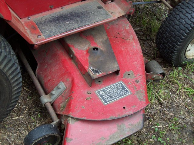

and @gp2 I know you mentioned that your deck is a 42".  It may have been replaced with a 42".  I'm pretty sure they were outfitted and sold with the 48, I mean, I could be wrong, but who knows. haha

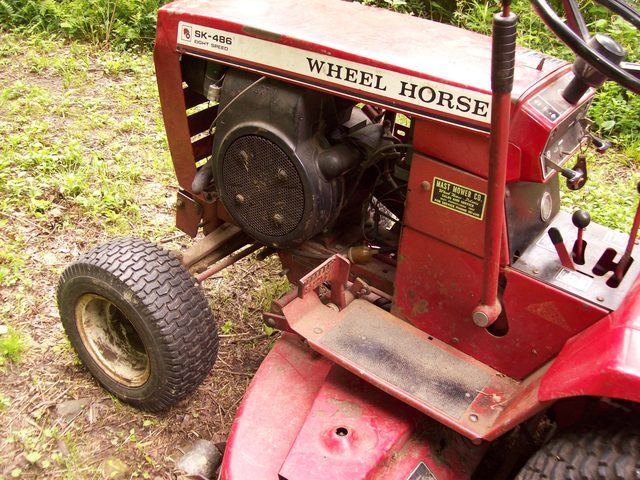

Thanks for directing me to the manuals.  I was looking for the serial number, which I could not find.  I had no trouble finding the Kohler model K341AS and SN. But not so for the tractor.  Any thoughts to where I can look.  I would like to confirm the date it was manufactured.  Also, I assumed a 42" deck...I'm headed out now to measure...It is a 48".
stratostar250
the tractor serial plate on those models was normally under the dash, above your amp meter, and that looks like a 48" to me!
