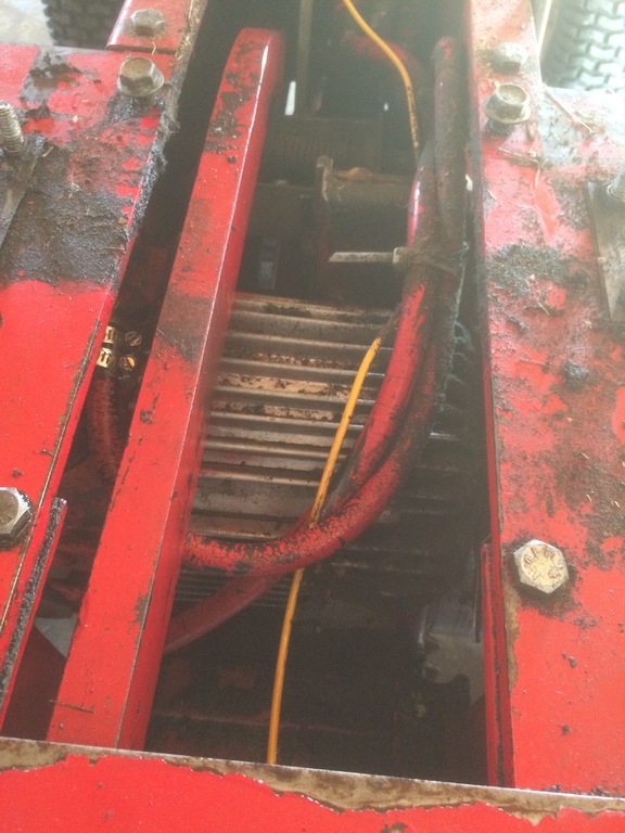

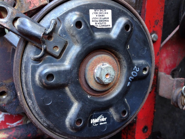

PeacemakerJack 10,837 #27 Posted August 14, 2016 I was able to get the PTO removed from the parts tractor today and install it on Blackbeard only to find out that my power wasn't making it past the switch. 12v going in only about 2 making it out. So, when I have more ambition, I'll see if the switch is indeed bad or if it is just the connectors are corroded.... It was fun to hear Zach ask to take a ride on his tractor and be able to tell him yes. We jumped on it and he drove me all around the yard. His is getting the concept of driving more and more every time he is behind the wheel. 2 1 Share this post Link to post Share on other sites
PeacemakerJack 10,837 #28 Posted August 14, 2016 My lovely wife is an OR nurse and has been for over 15 years. She is on call this weekend and got called in last night. So, I decided to go out and monkey with Blackbeard some more. I cleaned all the terminals on the PTO switch but I still got a zero current pass through reading to the PTO. If you read the beginning of the thread, you'll see that the PTO was missing when I bought the tractor and all the wiring in that circuit was fried. I have replaced all that wiring and I hoped the switch was still good. No dice. Have I said yet that I'm glad to have a "parts tractor". I crossed my fingers and tested the switch from that tractor. IT WORKED. . The PTO is on and the wires are all hooked up. I have two questions though: 1. Is there an air gap setting for the PTO and if so, how to I set it? 2. I only see one fuse for all the electrical system. Can I put a fuse between the switch and the PTO or would that just blow everytime I turn it on? My thought is to protect the switch from cooking again if the PTO fails... The pulleys are original but the magnet, field coil, and bearings appear to be much newer. Another point of interest--I put up two large fluorescent lights in my shop today. What an improvement! Now I can work at night and actually see!!! My lovely wife pointed out, "your shop has always been messy, now you can SEE that it is messy!" Thanks Hon! Time to clean and organize... 1 2 Share this post Link to post Share on other sites
oldredrider 2,553 #29 Posted August 14, 2016 You should have a 4 position ignition switch. The ACC position will allow use of the lights and PTO. This circuit should be fused and will prevent meltdowns if there is a malfunction. If I remember correctly, it uses a 15 amp fuse. 3 Share this post Link to post Share on other sites

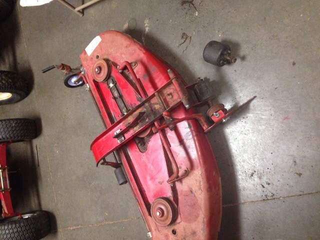

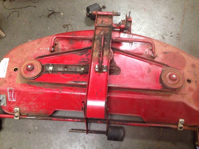

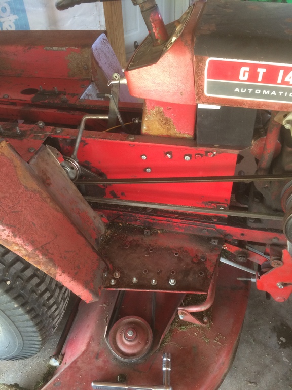

PeacemakerJack 10,837 #30 Posted August 15, 2016 Now that I have a functioning PTO, I have turned my attention to the deck. Overall, this thing is in good shape for being 46 years old. The gauge wheels and bolts were not surprisingly shot. The tensioner pulley had no bearing left in it anymore but the spindles, bearings, and main housing all seem to be in good shape. what i find fascinating Is the condition of the paint on the deck under the tractor. I just wish I could've gotten this tractor directly from the original owner where it had been stored inside. I can only imagine how sharp everything would've looked. I have to pick up a fresh PTO belt and put a new tensioner pulley on then sharpen the blades and I should be ready to test it. 1 Share this post Link to post Share on other sites

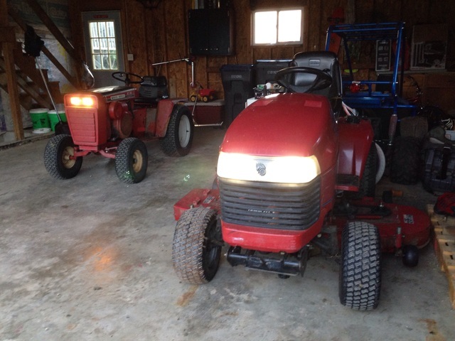

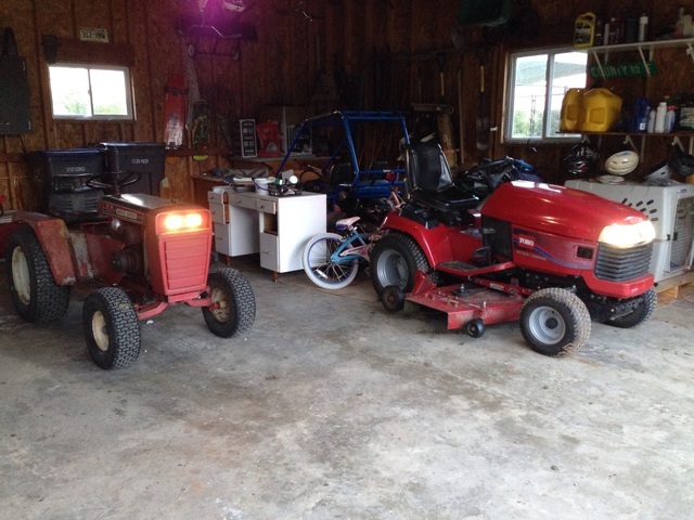

PeacemakerJack 10,837 #33 Posted August 20, 2016 Tonight, I moved Blackbeard into the main garage tonight and realized it was the first time that I had him next to "RED" (my Wife's Dxi). I thought it was a cool pic with the biggest model of the WH line in 1970 and the biggest of the ToroWH line about 30 years later! I purposely turned on the headlights on both tractors to show the different between the VLEDS in RED vs the old incandescent bulbs in Blackbeard! cool stable mates I think! 5 1 Share this post Link to post Share on other sites

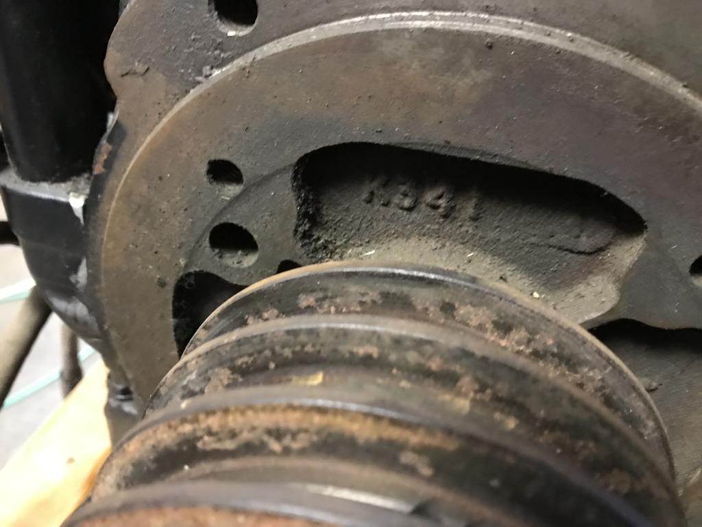

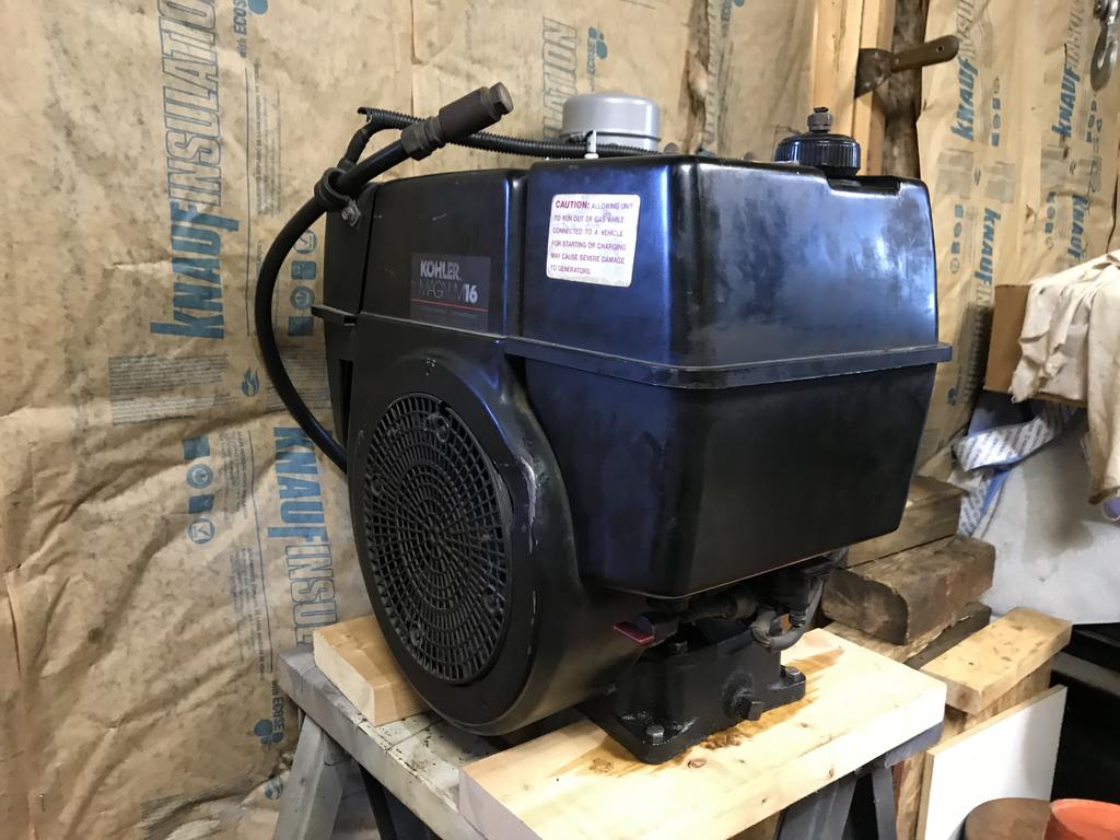

PeacemakerJack 10,837 #38 Posted August 1, 2019 I have a technical question for those of you that can supply me with an answer that I could probably find out fairly easily if I had the time to investigate. Does anyone know off hand what the crank output shaft dimensions are for the GT-14 K321? i found a possible repower engine for Blackbeard. If the output shaft is correct, I’ll pull the trigger and get this thing back up and running. I’ll save the original motor for a full rebuild when Zach is in his early teens. He has been really bugging me about getting it running and rightfully so—it has been nearly 2 years since we’ve used it for anything because of how tired the engine is... 2 Share this post Link to post Share on other sites
Achto 30,166 #39 Posted August 1, 2019 It should be 1 1/8" Josh 1 1 Share this post Link to post Share on other sites
PeacemakerJack 10,837 #40 Posted August 1, 2019 4 minutes ago, Achto said: It should be 1 1/8" Josh Thanks Dan. Do you know off hand the length? 1 Share this post Link to post Share on other sites
19richie66 17,765 #41 Posted August 1, 2019 Don’t quote me but I believe it is 3-1/4” 1 1 Share this post Link to post Share on other sites
PeacemakerJack 10,837 #42 Posted August 1, 2019 45 minutes ago, 19richie66 said: Don’t quote me but... The minute I saw this Richie and the fact that is says “Quote” directly under your statement...I couldn’t resist! Thanks. I’ll keep you guys posted on what I decide to do with it... 2 Share this post Link to post Share on other sites
Pullstart 68,518 #43 Posted August 1, 2019 Looking forward to seeing Backbeard taking a stroll through the garden plot! 2 1 Share this post Link to post Share on other sites
PeacemakerJack 10,837 #44 Posted August 2, 2019 me too! And Zach especially! 1 1 Share this post Link to post Share on other sites
19richie66 17,765 #45 Posted August 2, 2019 Just measured the crank on the engine from Skittles....3-1/2” long, 1-1/8” diameter 2 1 Share this post Link to post Share on other sites

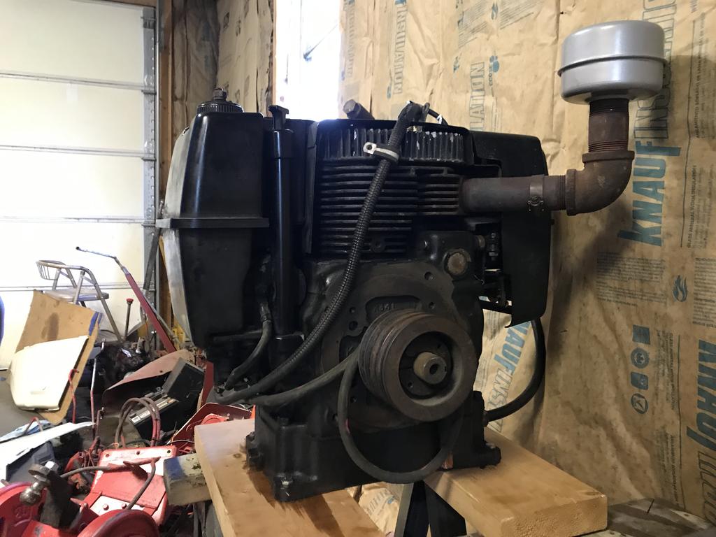

PeacemakerJack 10,837 #47 Posted August 2, 2019 That is VERY tempting and may be a great course of action. However...the plan is to work this machine pretty hard over the next 8-10 years and then do a full restore with Zach. He will be my last kid to do this withand so my thought was to preserve the original engine from that additional wear and tear plus the engines that I have been looking at have between 50-200 hours total run time—so they are basically brand new. I will run a Magnum series motor in it much like GhostRider has (I love that engine!) which should allow me to keep the wiring and switches factory. I’ve thought about installing a WH mechanical PTO in place of the factory electric one but we will see. Zach of all my kids seems the most interested in mechanical things and I have a feeling will love to help me work with his Blackbeard. I want to make sure it is reliable, so that he can get on it and go. I am so glad that I have the factory original K321 for his tractor but methinks that going with a different motor for the next decade might be the best avenue. I’m definitely open for discussion and welcome thoughts. All of this is preserved (right here on the forum) for Zach as he grows up on this machine... 2 1 Share this post Link to post Share on other sites

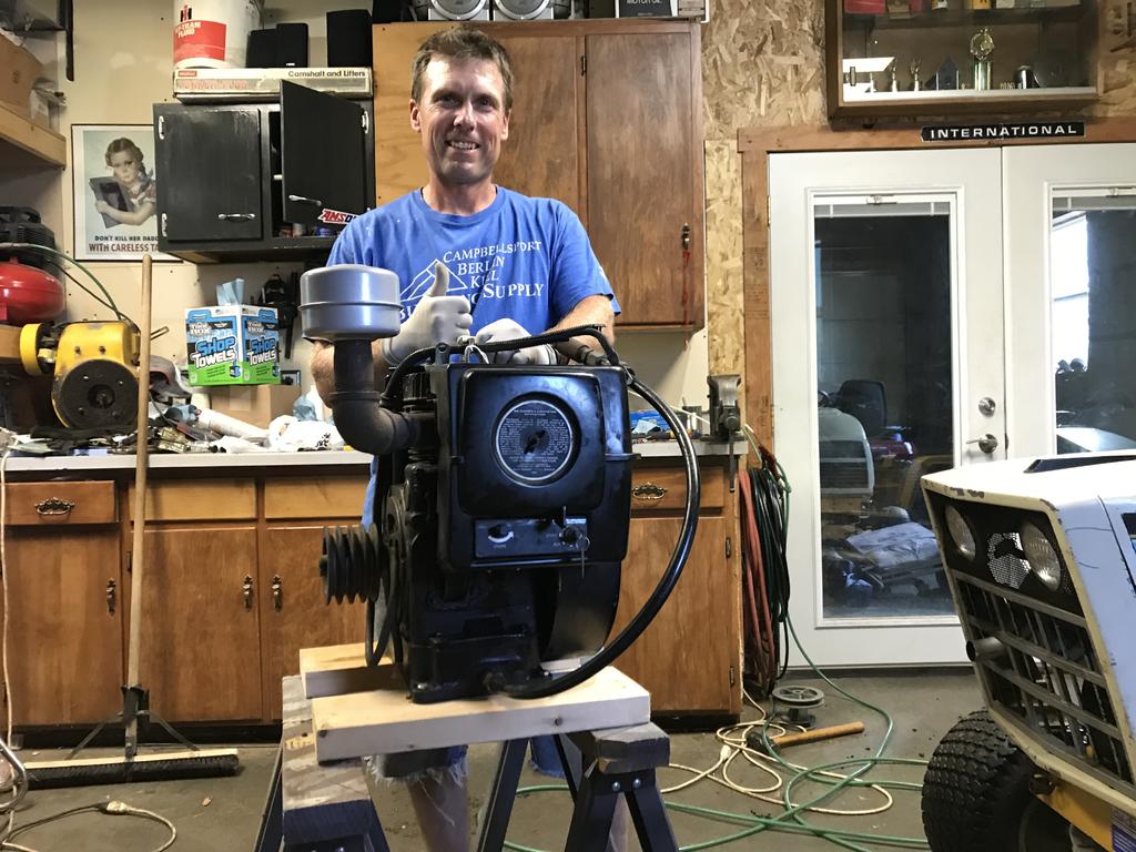

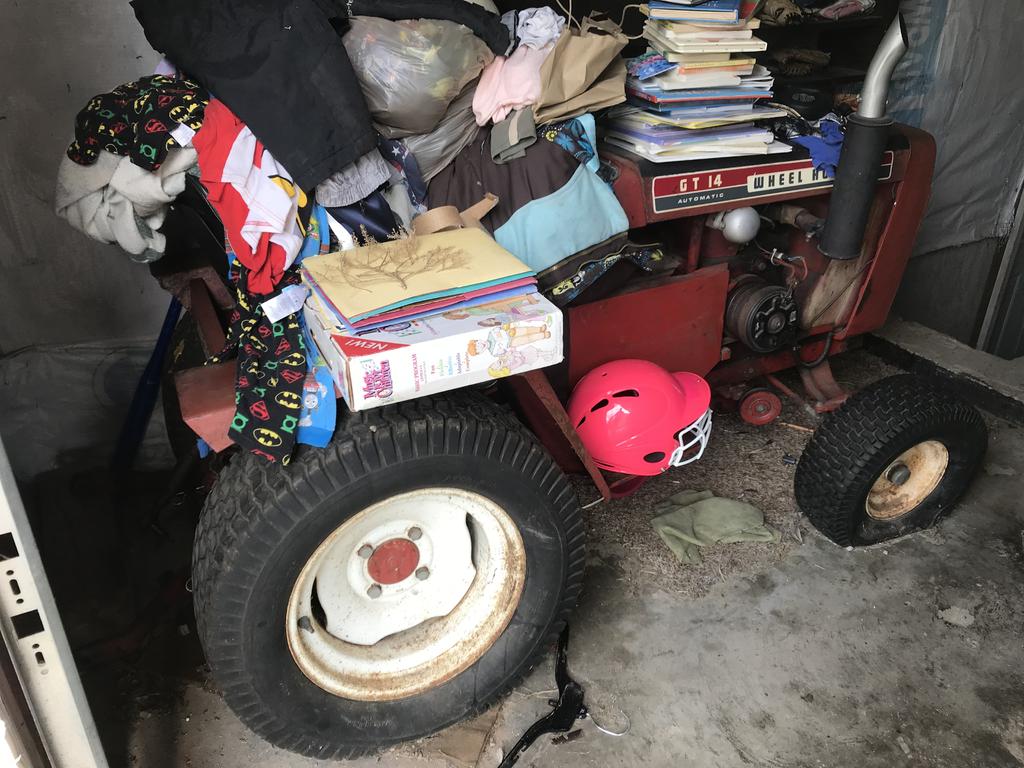

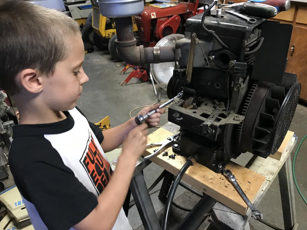

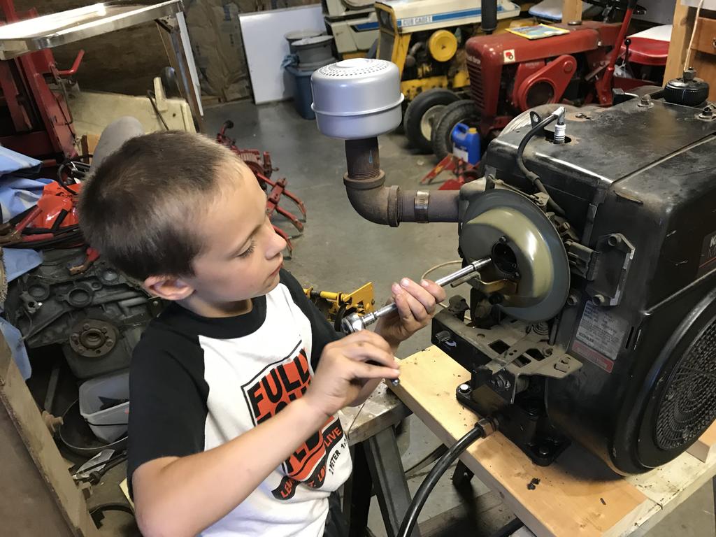

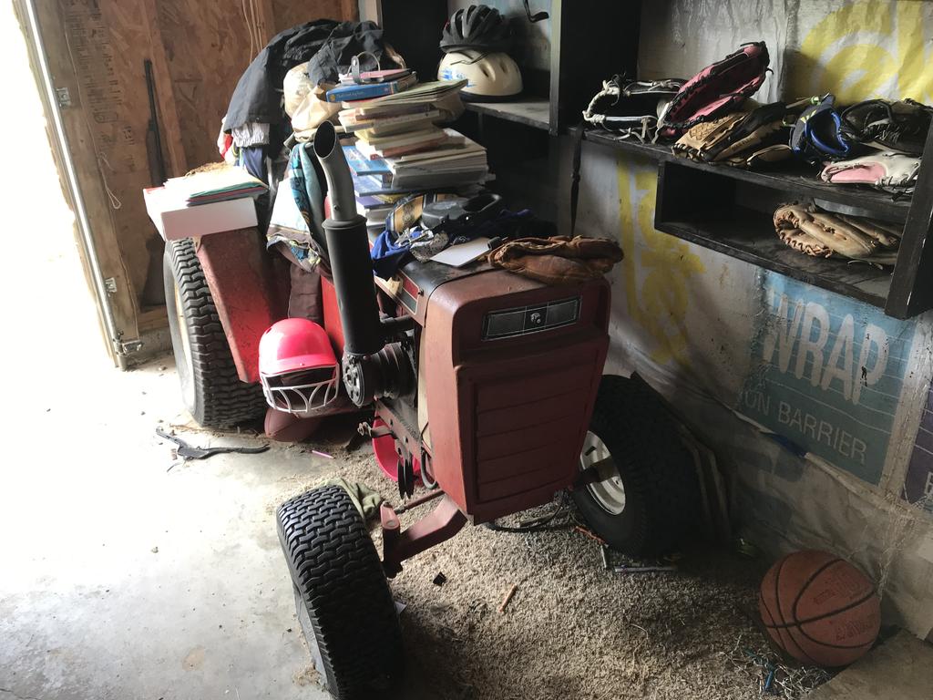

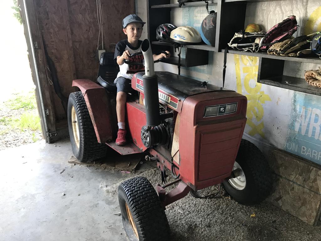

PeacemakerJack 10,837 #48 Posted August 4, 2019 They say that confession is good for the soul... This is what Blackbeard has digressed to after a couple of non running yearsbut today that will begin to change. After church this morning, we have loaded up and are headed to pick up a “new heart” for Blackbeard from “Davy Jones Locker”(gotta be a Pirates of the Caribbean fan to get that pun!). Anyway, Zach is super Excited and I’m looking forward to having another good worker in the Stable! More to follow. ”A hunting we will go, a hunting we will go...” 2 Share this post Link to post Share on other sites

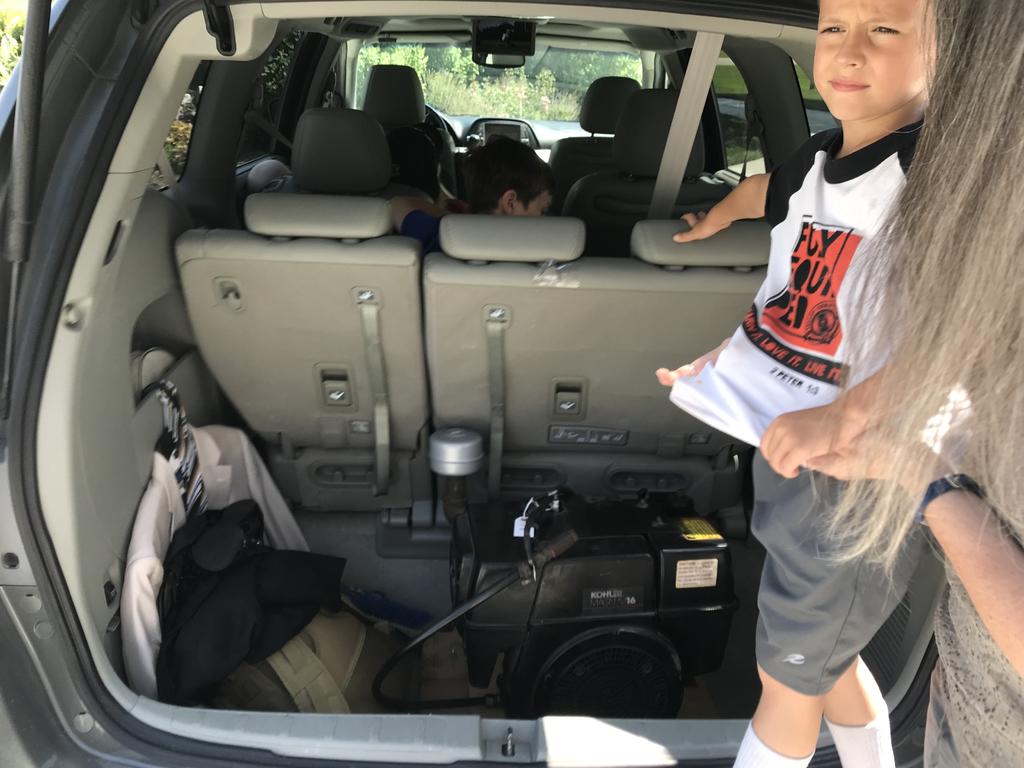

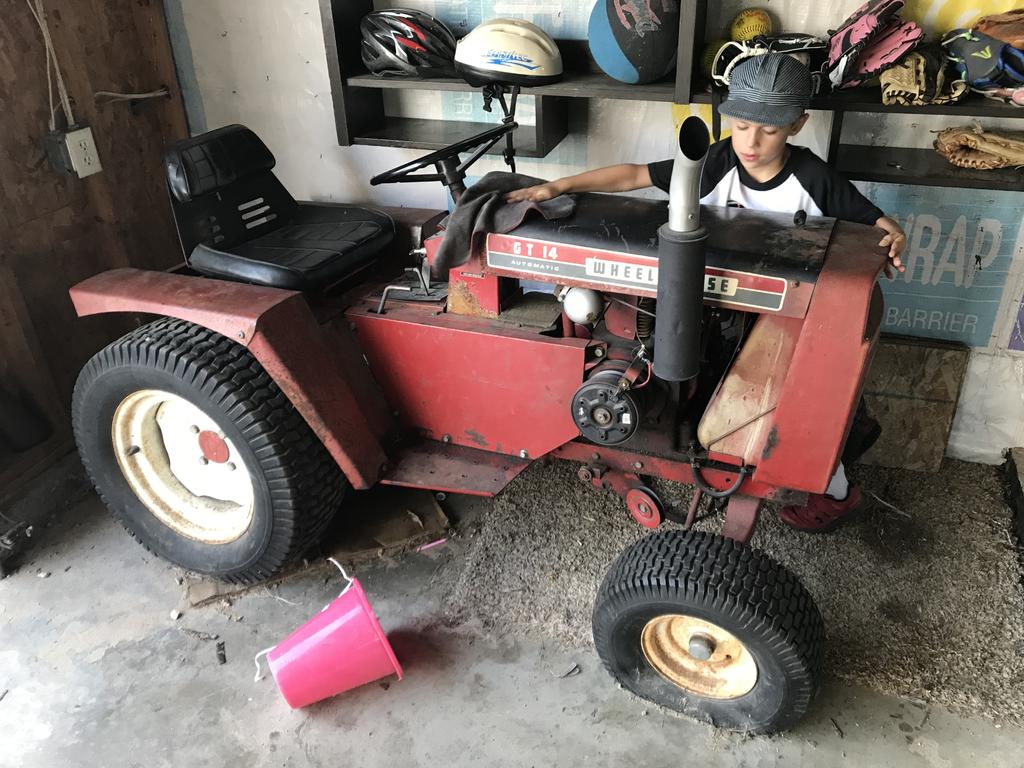

PeacemakerJack 10,837 #49 Posted August 4, 2019 Zach was able to come along to get his new engine... I forgot how big an M16 engine really is...what a Hunk of steel. Rick was so impressed with the whole situation, he decided to knock $50 off even though I handed him the cash for the total price. I can see that I’ll be installing an engine soon... 3 3 Share this post Link to post Share on other sites
PeacemakerJack 10,837 #50 Posted August 5, 2019 We went on a family hike this afternoon at a local state park that was nearby the sellers location and that meant we didn’t arrive home until about 5:30pm. I don’t think the front wheels of the van had even hit the driveway when Zach piped up from the backseat, “Are we gonna get working on Blackbeard or what?” I told him that the first thing we needed to do was to remove all the storage shelf stuff from the tractor and then clean off the dust. He worked on that with some assistance while Caleb and I got the beast out of the van and into the shop. That big ole’ K341 is a handful. I’m glad that Caleb is getting stronger and able to help me do some of these things that I can’t do easily by myself anymore. This is a stationary engine designed to run something off a utilities truck. Anyone who has a thought on what it might have been, please chime in. I know that it has a triple pulley that needs to come off! Zach finally got his tractor cleaned off and was very satisfied with the result of being able to sit on HIS MACHINE for the first time in awhile. The first thing he says to me right after I took this picture, “Dad, can you show me how to start this tractor? I don’t remember and I need to know how since it is mine!” This kid is inquisitive but also really sharp. The stationary engine has a whole lot of stuff that we don’t need and can’t have on it and so Zach and I spent about an hour removing it all. It had the self contained panel with ignition switch, choke, and throttle. It had the attached fuel tank and starter solenoid. Zach was sooooo excited to get hands on and learn. He did much of the disassembly himself with just simple guidance from me. That designation tells the story! These are powerful engines no doubt. When we removed the fuel tank, we discovered that the engine had obviously been painted after the tank was installed. It had that goofy greenish tan “factory paint” which kinda reminded me of a military application color. Here Zach is removing the ignition bracket. Thankfully the engine does have a fuel pump on it. The fuel system is really varnished and so I’ll be sure to pull that and clean it with the carb unless I choose to spend a little more and install an electric pump. It was a great day and lots of fun with my youngest! 1 2 2 Share this post Link to post Share on other sites
