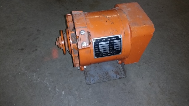

ricksrj58 273 #1 Posted June 6, 2016 i picked up a nice 5000 watt generac alternator model 6511-1 for $60 at centre hall over the weekend.i was told i would need a 12 horse or larger to use it,is that right? it did not have a tractor mount with it so if any one can post a pic or two of the mount and how it adjusts the belt tension i can fab one up. thanks.. 5 Share this post Link to post Share on other sites

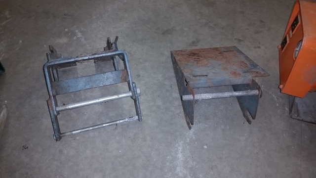

WHX?? 49,512 #2 Posted June 6, 2016 This stuff came with a 520 I got awhile ago. The bracket on the right appears to get mounted on the front attachmatic mount and it runs right off the pto. I have no idea what the bracket on the left is for. I also have no idea what tensions the belt yet as I have not had the time to play with it yet. At 5 kw a 10 hp should run it but 12 would be better. What tractor do you plan to use it on? Share this post Link to post Share on other sites

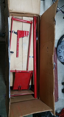

wheelhorseman 3,211 #5 Posted June 6, 2016 Not mine just some pictures that might help you out 3 Share this post Link to post Share on other sites

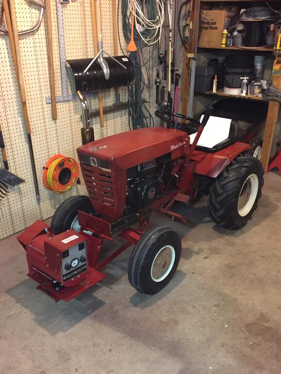

squonk 41,650 #6 Posted June 6, 2016 (edited) Here's a Gen U Ine Generac on Marvin. with a home made mount. The bolt you see sticking out in the front goes thru a welded on nut for the tension I'll have that Jenny on my C-160 at the show. I have run it on my 73 12 also. Edited June 6, 2016 by squonk 1 1 Share this post Link to post Share on other sites

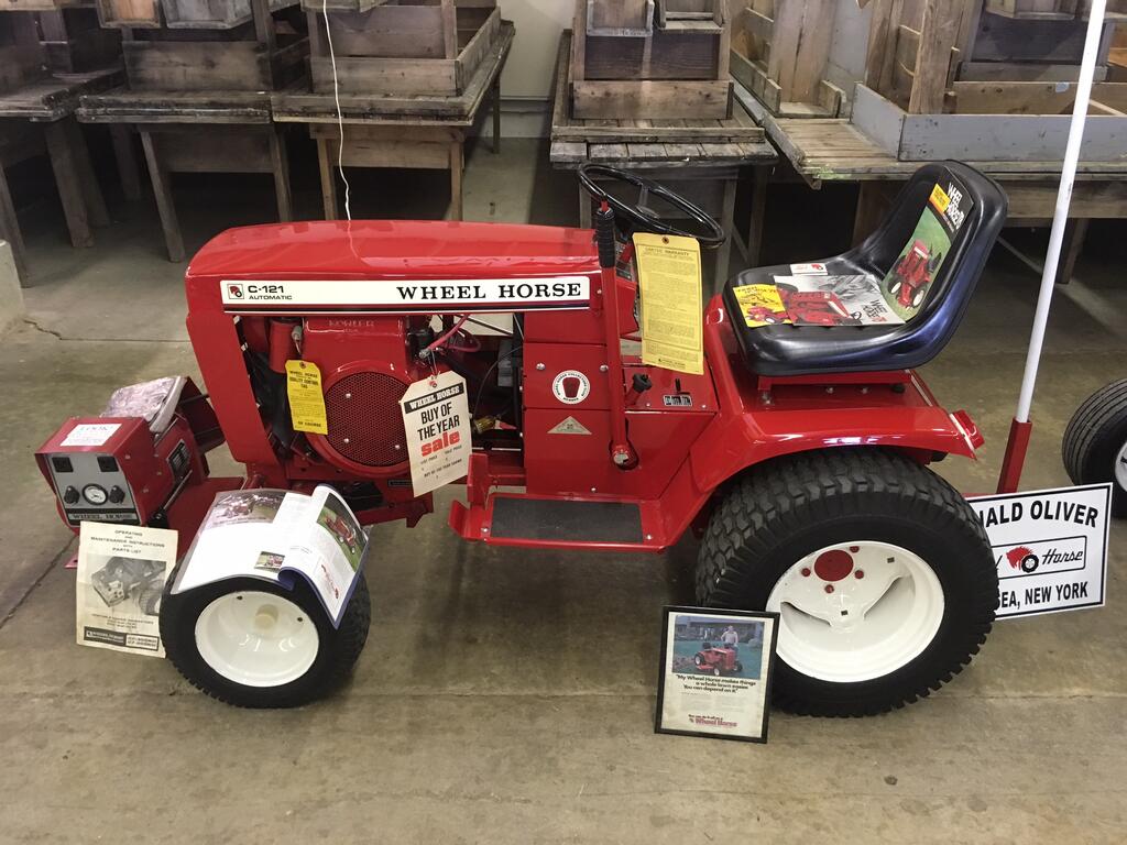

c-series don 9,065 #14 Posted July 22, 2021 Here’s my C-121 Automatic with 3000 watt generator 1 3 Share this post Link to post Share on other sites
