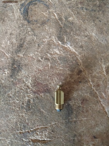

I was cleaning carburetor and noticed the rubber tip on the float needle is bad. Where can I get this part?
608KEB
Is the carburetor  for a Onan p220g a b43? I'm not sure but Jacks small engine has a universal  float needle part 1420553 could someone  confirm this before I order it.  Float valve kit. Is $14.22. I did order one carburetor kit from Onan parts $47.00 plus shipping. I just wanted one to have on hand. Thanks.

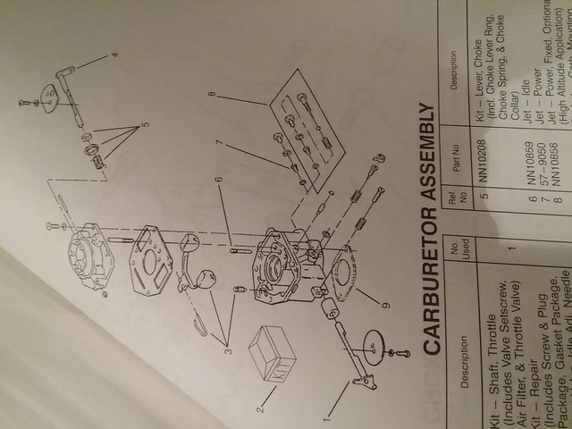

608KEB
Thanks, I'm thinking your right. I have a parts catalog. I see which jet is the idle jet. I'm soaking that and the top of carburetor overnight. I'll try the compressed air tomorrow. Blow everything out.20160531_213101.jpg
WNYPCRepair
I took a piece of solid 24 ga wire (computer network or phone cable), stripped it and poked it through any holes I found. then blew everything out, then sprayed carb cleaner through
boomers_influence
608
# 6 is the one you want to clean.
you MUST also clean the CENTER hole at the bottom.
a torch tip cleaner works very well. ( .020 tip )
thank you boomer ( the used onan engine parts gut, also NOS and new )
