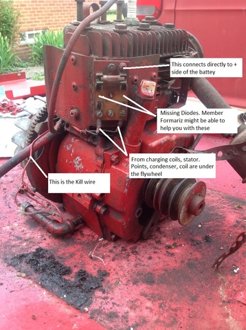

I am going to rebuild my H55.
i am taking pics to remind me where it goes and what it looks like, but the fuse block had been disconnect years before I got it.
can someone explain the wiring to/from this block?
is it possible to put lights on this electrical system?

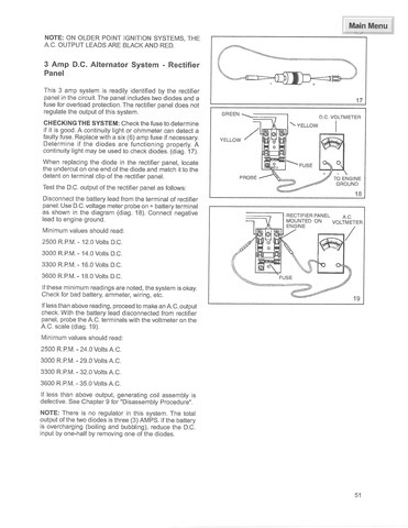

Not sure but I think member @formariz had some of those diodes. If memory serves me correctly, the charging system is 3 Amp and if running for long periods of time it was recommended to remove one of the diodes so the battery doesn't over charge. There is no regulator in this system, just the rectifier to transform AC to DC power.

@formariz will tag him for this thread. The first one didn't seem right for some reason. The diodes weren't expensive.
Maybe someone with electrical experience can recommend a modern rec/reg that will work if you prefer to go that way.
Member @puddlejumper did a couple of these engines too but he doesn't post as much anymore, so try sending him a PM. Bet he can help with what parts from what other engines will work in the H55.

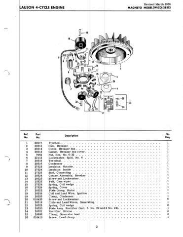

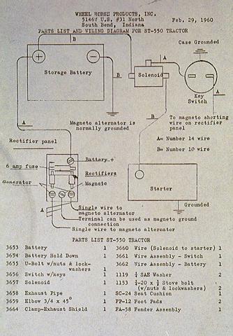

I have the diodes if you need them. Just PM your address. Attached is some important information pertaining to that system. My first experience with engines was with h55's. Learned quite a bit about them.
