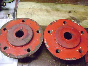

I had (I believe) a B80 that I parted. It was rough. It had a Kohler on it mounted to a plate but not a shaker plate. The trans was not a high/low. The tractor had cast iron hubs on it but the center raised portion was smaller than regular hubs. The rear tires / wheels are 10" instead of 12". I tried to get them off but one shattered and I need a pair of these so I can use them on my lawn ranger. What hubs would I look for as I didnt have a model number on the tractor. It was gone. Hubs looked like the ones in the picture except smaller center raised area. Thanks, Richie

Are you saying the center section is smaller in diameter? I think you're talking about a Commando 800. They had 10" rears. The B-80's had 12". What baffles me is that I restored a Commando 800 for my grandson and I don't recall that difference. I did put 12" rears on it off a B-80 and the center hole is tight. I don't remember changing the hubs but maybe I did. :wacko:

Ill try and get some actual pictures when I get home if its not pouring down rain when I get there. The 10" wheels will not fit over the center of a regular hub. 12" wheels will go on them but there is a gap between the wheel center and hub center

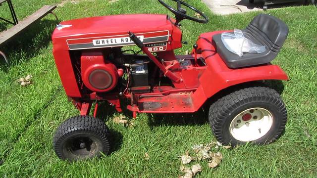

Ill check when i get home. Here is a picture of the wheel. Pretty much same tractor just wasnt that nice.
Racinbob
That might help in the search. Commando 800's were pretty common so there's got to be some floating around.:)

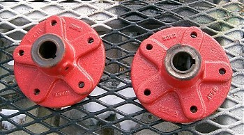

Hey Bob, part numbers 4996 or 6465. I think thats it.
Racinbob

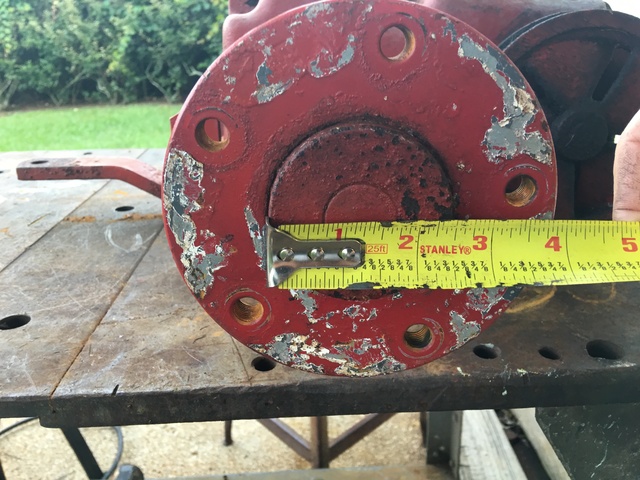

Richie, 4996 is a common hub used with the 12" wheels. The center raised area is 3.125" in diameter. I was thinking that you were saying that the 10" wheels won't fit that hub.
19richie66
2-1/2"
Racinbob
Ok, you need a set of hubs to fit a wheel with a 2.5" center hole. That hub isn't a 4996. Is there a part number on that one? :)
