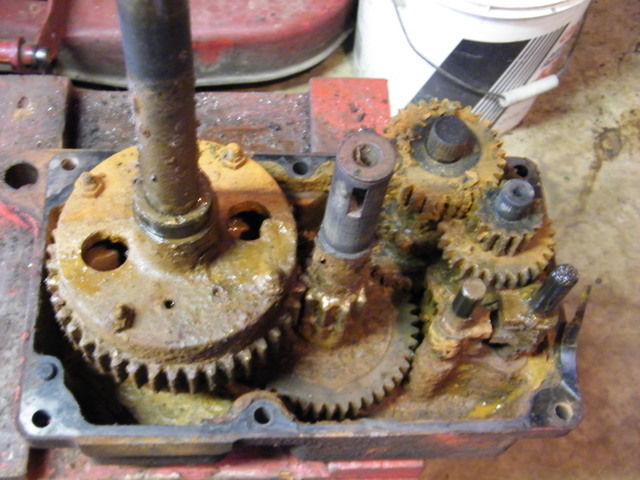

so heres some pics of what I have done in the Las week.
so above was the results of soaking in diesel for a week. And though some things wiggle I still cant, as the manual directs, pull out the spline shaft and other shaft....(first pic above)...
I'm wondering if in the next pics the damage from these bolts are indicative of someone else has been in there and not only put the wrong bolts in backwards but maybe they put the gears in wrong also? Thinking cause all the gears wiggle and move separately but wont turn together as a whole unit.

From what I can see, your trans is put together correctly.  The differential has the nuts to the left side as it should...the length of those bolts is in the parts list, if those are too long.  If you can't get the spline shaft out and/or that reduction gear off of the cluster gear shaft, I suggest you take off the other side plate.  The mushroom gear will come out then (from the right side) and you can work backwards from the manual to get the rest out.  :handgestures-thumbupright:  The diesel fuel really just loosens things up.  The phosphate thingy looks interesting for sure.  :)

the other side plate will not let go of the gears (I think the cluster and the long spline against the diff) even though they all wiggle its as though they have a pin driven to hold them to the side plate?! I mean they are on that strong! It slides on the axle shaft and the drive shaft but nothing pulling. So I thought to put it back together since everything wiggling, and I tried to make things spin again...gears will move and play but one input wont spin another and the axle shafts wont spin the brake shaft etc...
I used heat on the spline shaft hoping it would help pull but nothing budged....and I have nothing good to grab or push against to pull that shaft out, I'm worried pulling on it too hard will put to much force on the shifter forks

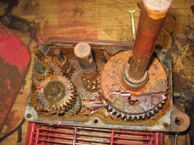

this is where I started today
  • Like 1
psalms83:18
that side pulls off sooo easily
then all of four of the gears on the other side plate wiggle freely but would not slip from the bearings or there seatings...
so I pulled and pushed them out..and it took quite a bit of force but nothing seemed damaged yet
well that part was a fight
and the next three were also
  • Like 5

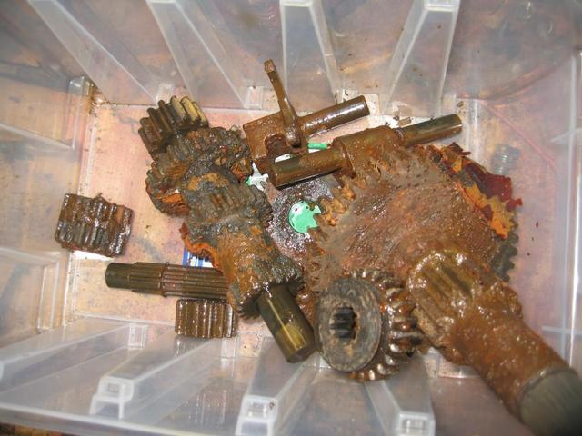

psalms83:18
so that smaller gear there...is that stripped or supposed to be less at the tip cause it actually kinda set into the other gear ahead of it
and this was just the last peices
  • Like 5

It's not stripped. There's some wear but it may be OK. It engages the internal teeth of the 3523 3rd/2nd gear. Once you get them cleaned up take a good picture of both gears.The engagement of the two is a weak link in these transmissions and the cause of them slipping out of 3rd gear. :)
