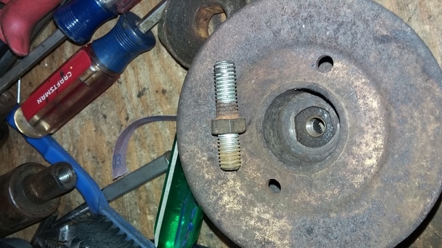

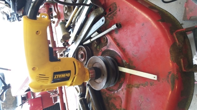

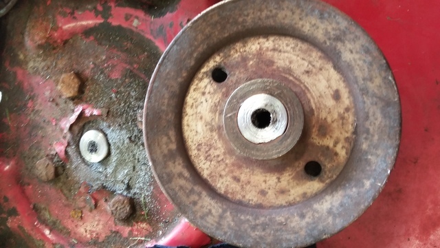

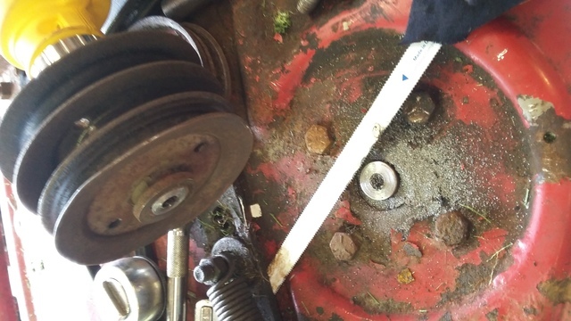

BOB ELLISON 2,981 #1 Posted May 8, 2016 I had to replace the spindles on my b80 36" rd deck.the two on the outside were not bad but the middle one with the double pully would not budge.i put a steering wheel pully on it ,soaked it with penetrating oil for 2 days and nothing.heated it with torch it would not move .so I decided to try to cut it off.hack saw wouldn't fit so if I can't cut it without cutting the deck I had to think of a way to GITTER DONE .So what would Larry the Cable guy do.Then I got an apiffiney let it cut its self.This worked like a charm and only took about 5 minutes of cutting. After cutting it off I put it on my work bench and beat it out. And I mean I had to beat on it I did save the pully and reassembled it . Ok now and works great. All I used was a 3/8 16 x 2" stud that screwed into the spindle . a 3/8 drill and a new hack saw blade.hope this helps someone. 11 Share this post Link to post Share on other sites

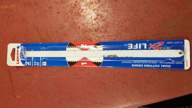

gwest_ca-(File Mod) 11,186 #6 Posted May 9, 2016 That is an interesting hacksaw blade. Never seen one like that before. Garry Share this post Link to post Share on other sites
Ed Kennell 39,800 #7 Posted May 9, 2016 Good eyes Garry. I never saw one of those either. BOGO 1 Share this post Link to post Share on other sites

elcamino/wheelhorse 9,360 #11 Posted May 9, 2016 I just noticed the hack saw blade ( double sided ) what brand are they? Share this post Link to post Share on other sites
BOB ELLISON 2,981 #12 Posted May 9, 2016 55 minutes ago, elcamino/wheelhorse said: I just noticed the hack saw blade ( double sided ) what brand are they? I got them at Lowes the one I used was this one in carton it was new when I started didn't even hurt it so I put it back in carton for next time. 12 hours ago, gwest_ca said: That is an interesting hacksaw blade. Never seen one like that before. Garry lowes lenex 1 Share this post Link to post Share on other sites
