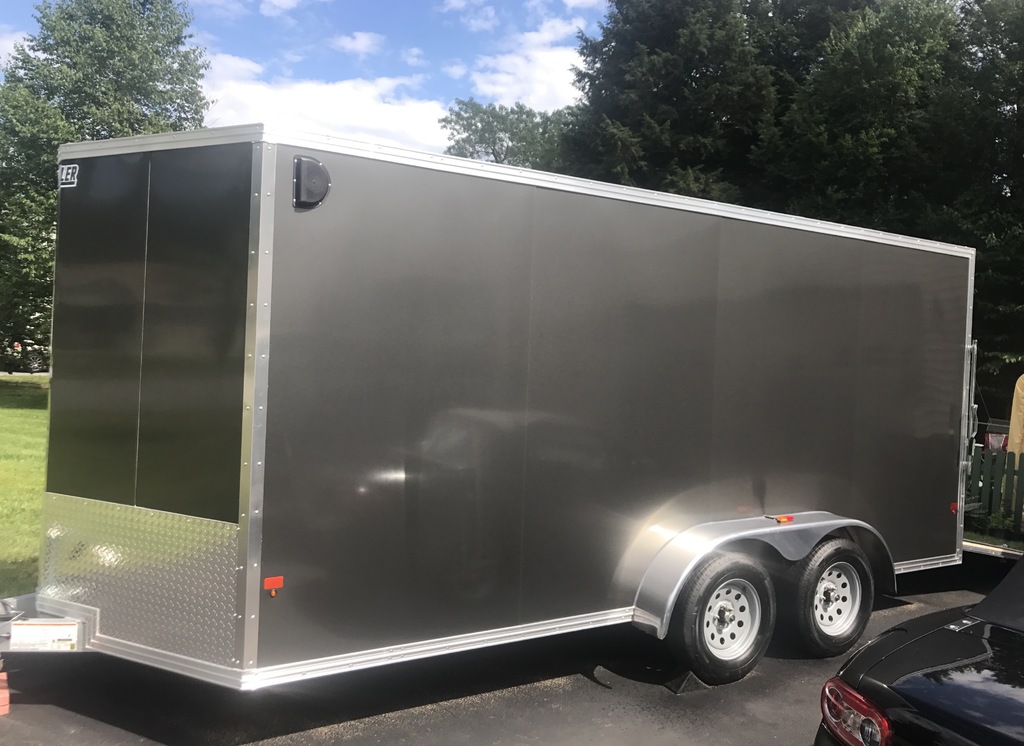

Aldon 4,828 #84 Posted June 8, 2017 Well, I bit the bullet and bought a dedicated horse hauler. I have not seen it mentioned in this thread so I'll tag my experience in on this for others to compare. I am planning on using U-POL Raptor. I'll post up pics of before and after but for now, just the trailer as noted in the WIMM "what's in my mirror" thread. 7 Share this post Link to post Share on other sites
Fun Engineer 860 #85 Posted June 9, 2017 Now that's a trailer Aldon. What are the dimensions? I've been using mine for hauling furniture and other things acquired over 40 years to a storage unit while our house is finished. The Monstaliner is holding up well. Look forward to hearing about your U-POL experience. 1 Share this post Link to post Share on other sites
Aldon 4,828 #86 Posted June 9, 2017 Thanks. Its 7x17. Aluminum so I can add a couple more tractors to payload. Until or if I can upgrade from 1500 to a 2500 pickup at some point. Share this post Link to post Share on other sites
WHX?? 53,319 #87 Posted June 9, 2017 (edited) ? Aldon I don't think I have ever heard of a 17 footer? Just 14 or 16 or larger to 18/20? Did you special order or off the lot? Maybe I just wasn't looking but as in this thread Im thinkin maybe I should have went to 16 like Tom. While I can get four full size tractors in it or more smaller round hoods the extra space might have been nice. What axles are under it? My 14 has two 3 K's which will handle more than anything I can throw at it. You might have mentioned it but what make? Like you I'm looking for a heavy 2500 truck as I'm long over due. Mine is all AL as well but after only one year save for that rustle to MN for a tractor in the salt is holding up ok. Cheap plating on the wheel hub covers and lug nuts aren't doing well tho. Ticks me off but my complaints fall on deaf ears. Edited June 9, 2017 by WHX11 3 Share this post Link to post Share on other sites
WHX?? 53,319 #88 Posted June 9, 2017 Might be an interesting conversation about AL versus steel and payload capacities Share this post Link to post Share on other sites

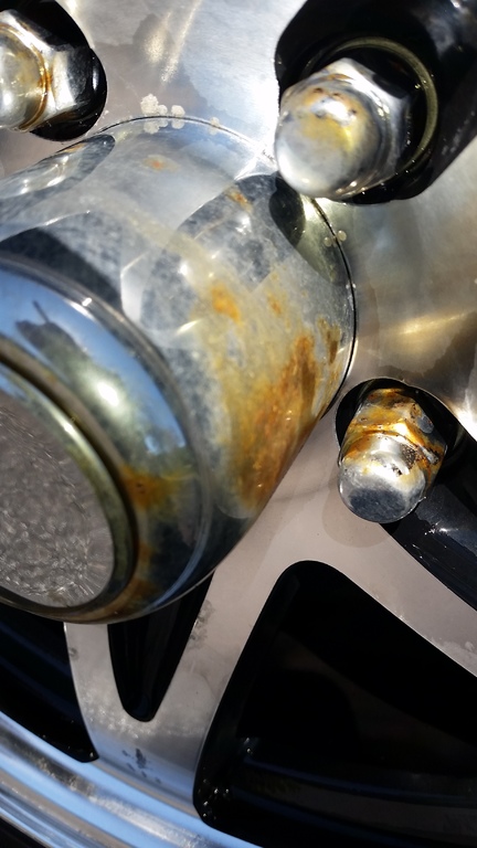

Aldon 4,828 #89 Posted June 9, 2017 (edited) It's a Ez Hauler. Aluma or Alco in Maine makes them for 3-4 trailer companies who brand them but all made at same locale. EDIT (Actually it is manufactured by "ALCOM ") 17 seems to be popular these days. At least out this way. With the blunted vnose it adds another foot or so. So you could get away with saying it's 18 but it's a stretch. All metal, aluminum, chrome and most stainless is attacked by the chemicals they use these days. i plan to undercoat the underside but also plan to use a protectant wax on the exposed aluminum. See pic. It gets pretty good reviews. If the dealer had had spares of those upgraded wheels like yours I'd likely have bought that upgrade. Mine are powder coated steel with bearing buddies. So they should be ok in the salt/snow at least for a while. 11 hours ago, WHX11 said: Might be an interesting conversation about AL versus steel and payload capacities It is not a case for aluminum vs steel in my case. Ultimately it might be but in my case with a 1500 my truck hits its recommend limit well before either designed trailer's max. As such, a 1000 pounds lighter trailer means 1000 pounds of more tractor and parts I can haul. Also. Axles as spring 3500's And I would note that it is what I deem my 2006 tired 1500's limit is. Ordinarily new fresh 1500 may haul it at max load.... Edited June 9, 2017 by Aldon 2 Share this post Link to post Share on other sites

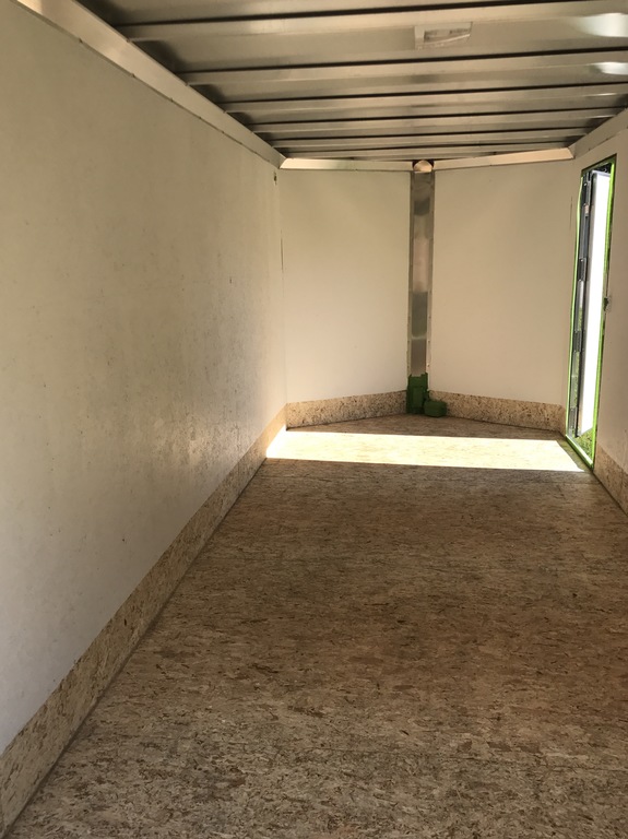

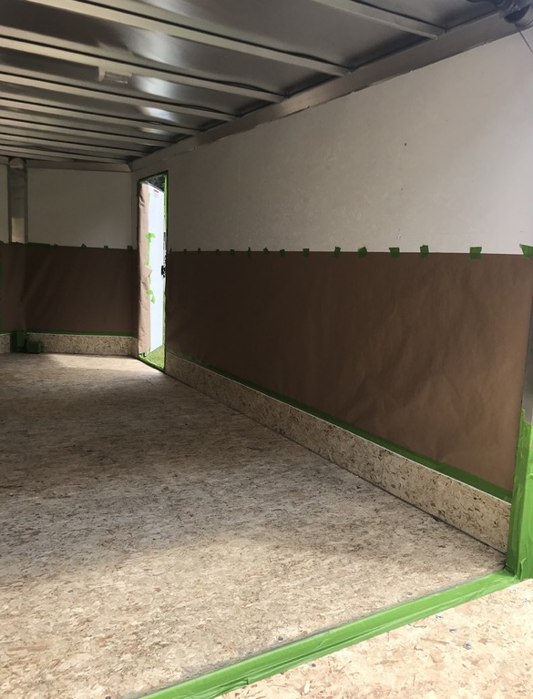

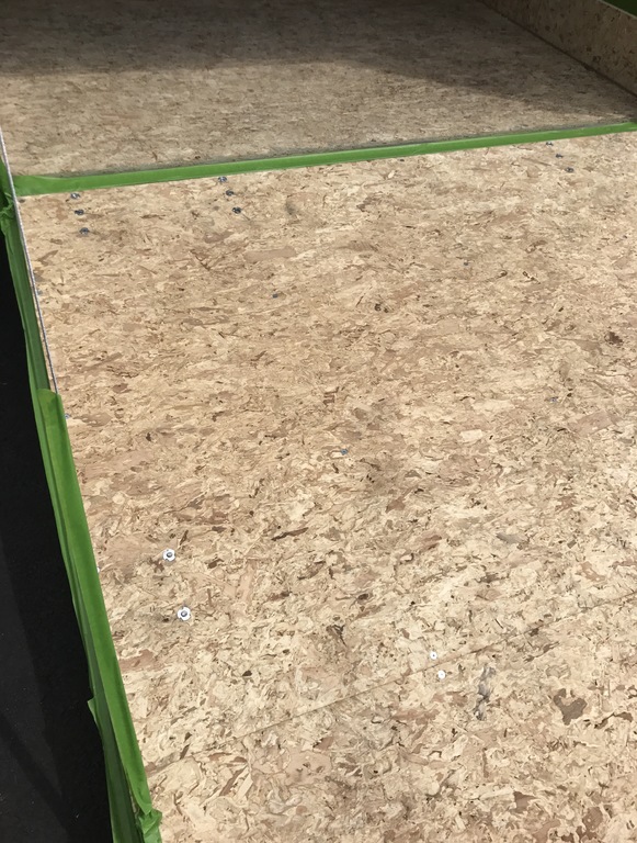

Aldon 4,828 #93 Posted July 4, 2017 So I got some free labor this week. My son and his fiancé visited. So wash and wax and then I prepped the interior. Dealer Binder followed by white on the walls and this morning I sprayed Upol Raptor on the floor and ~ 7.5 inches up the sides. For anyone considering this particular product, I bought 8 quarts. Mixed in just shy of 1/2 cup of sand for texture in each quart. It's a bit thin in a couple spots so the ideal for this size trailer would be 9 quarts and 10 would allow pretty thick coat. Also, it calls for complete cleaning of the sprayer with Acetone after each quart. I found this to be necessary. Texture is great. Time will tell if it will hold up but I believe it will be very durable. The sealer/binder coat is a necessity. 6 Share this post Link to post Share on other sites
