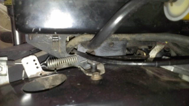

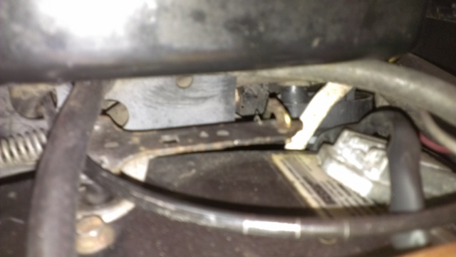

Here's where I'm at: Throttle all the way up, I max out at about 3200, then it creeps back to around 3000. almost all I do is mow with th 48" deck, Seems that a higher RPM will give a cleaner cut, when I really push the throttle up, and hold it in position I can get it to about 3500 but I have to keep my hand on it or it will creep back. I fiddled a little with the linkage and then I stopped thinking that the governor needed to be properly set.

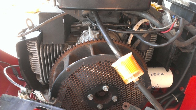

I thought I had CLEANED and degunked everything until I started reading more closely the posts and photos about chaff building up behind the flywheel and blocking airflow to the rear cylinder. Even though I could do a visual with a flashlight and it looked clean, I though I better check anyway. I took the "tin" off and everything was surprisingly clean so I decided not to push my luck and bolted it back together. At least now I know its moving air as it should. Thanks for the info on that.
I have attacked a picture or two of that process and a (not so good) view of the throttle governor linkages.

If you do a search for "throttle rivet" here, you will find a ton of posts on it, here is one. I would check this first.

Probably not a governor issue but like the others posted, most likely a problem the throttle lever having enough friction to hold tension against the governor spring.
