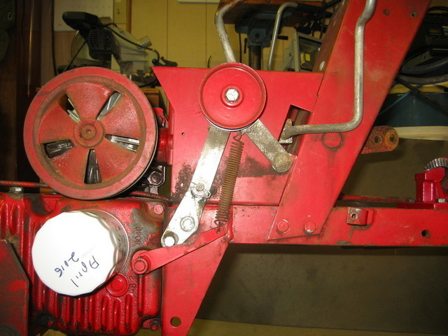

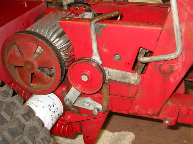

Working on: 1986 Wheel Horse 312-A, Model 21-12KE02, 42" Deck Model 05-42MR04
Hello All,
Well, the parking brake on this one stopped working, and after removing the shift plate it was clear that the pawl was no longer reaching any of the teeth on the bell crank. So I figured I needed to adjust the travel on the rod that accentuates the squeeze on the brake lining. It's not perfectly clear to me where the adjust point is, but I think it is the bolt-nut-spring assembly as shown on the pictures attached. Now, if that is the bolt I need to put some clockwise turns on to get this done, the question becomes how can I get a pair of 9/16" wrenches or sockets in there to make the turns. I pretzeled myself in several ways to get tools on both ends many ways with no luck. All comments very much appreciated.
I'm using these diagrams:
www.partstree.com/models/21-12ke01-312-a-toro-garden-tractor-1986/index.html
The first picture is taken from the right side inward toward the assembly. The second is taken with me on my back looking up.
